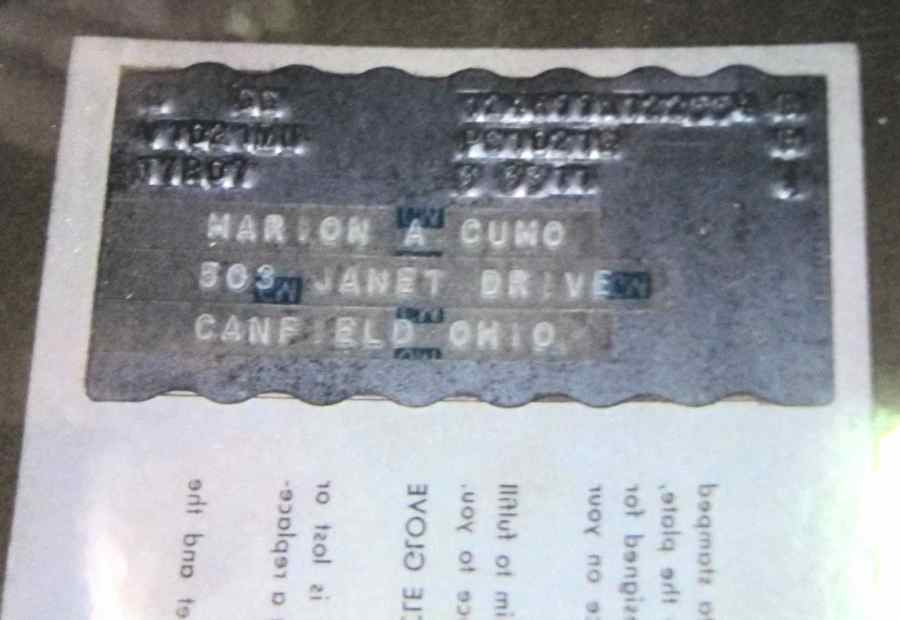

Subject VIN: 124677N122554
Drivetrain:
V1021MU
T7R07
PC1021G
Original owner:
Marion A Cumo
503 Janet Drive
Canfield, OH
