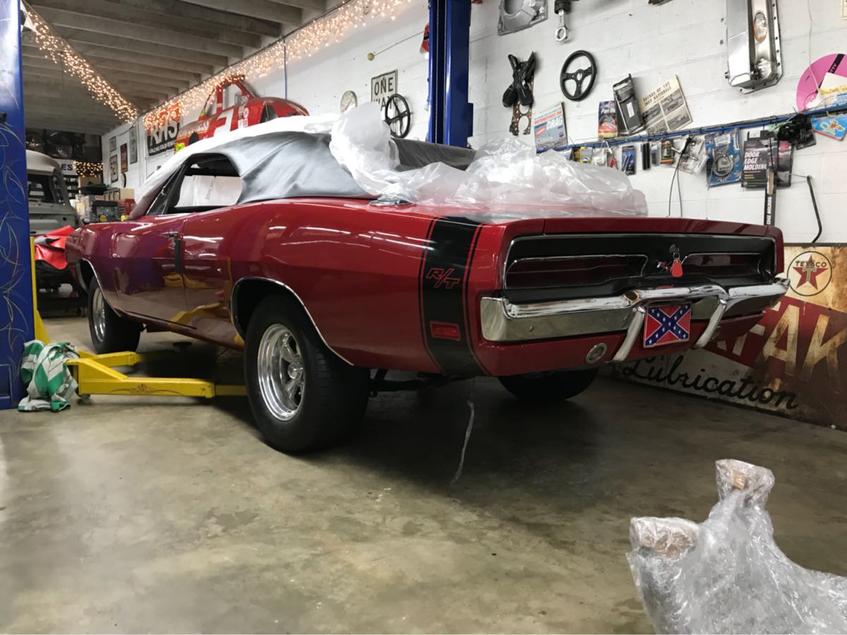

Here are a few more updated photos. The wheels are temp. The ones I want are actually the full chrome 68 Road wheels but they can’t be ordered until February. The tie wraps on the heater hoses are temp too.

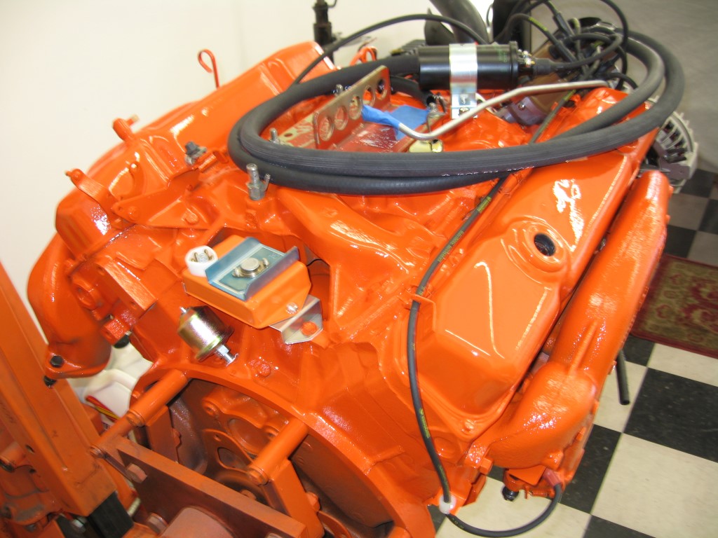

This was my 69 Coronet R/T 440
Throttle spring was later changed to silver and V.Regulator to one with proper date code and Yellow script
1972 SATELLITE SEBRING PLUS

Here's my old 70 GTX 440 showing the #8 wire holder, oil pressure switch, coil and bracket, vacuum fittings in manifold etc...
