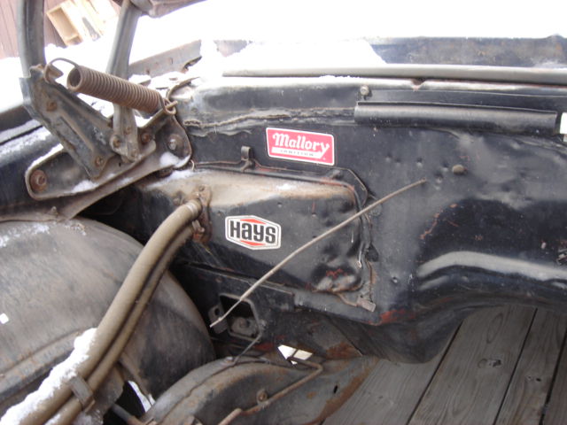

Hi Guys, I just bought this 1969 375hp Nova SS and the guy told me it was a L89 car. Do you know how I could verify it? It has the 12 bolt with 456 gears and it also has a fin on the back. Thanks
PS The picture is to big and I have to resize it.
Attachments - The Supercar Registry DSC05741.JPG DSC05740.JPG DSC05739.JPG DSC05738.JPG

Tim, There is NO real documention about L89 novas, built from the factory! BBBenny

If the car has a TH400 then there should be JM as the last two digits on the engine pad.
If the car has a 4 speed then there should be KE as the last two digits on the engine pad.
Example below is a Corvette 427/390 HP with manual trans (IL)
EDIT: It is not that difficult to restamp an engine BTW once it has been decked. So even if you see a JM or KE, without bulletproof documentation there is no way to prove your car has/had an L89 in it.

GM production records do not record any L89 units produced in a Nova in 1969
