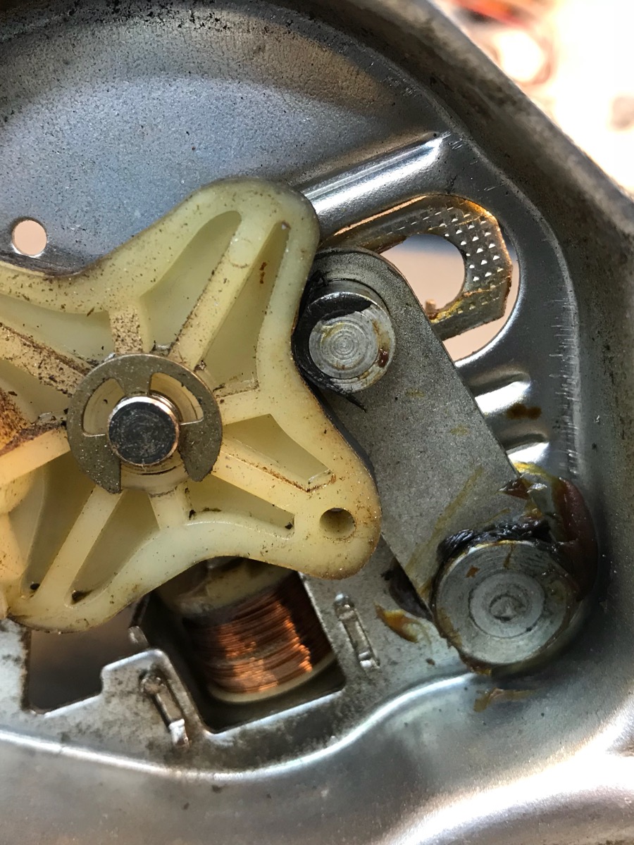

Ran into another snag: I am just about through dismantling everything and am stumped on how to remove this pin (shown in photo at 2 0’clock position). It appears to be held on by a washer-like piece. It is not a “C” or “E” clip. This pin pivots the lever on the other side of the housing (see 2nd photo, lower right corner) which actuates the washer pump.
Thanks,
Sam...

That pin is pinched on and non removable to my knowledge. There is really no reason to remove it as that area can be cleaned with it still attached. Same if you have plated.
