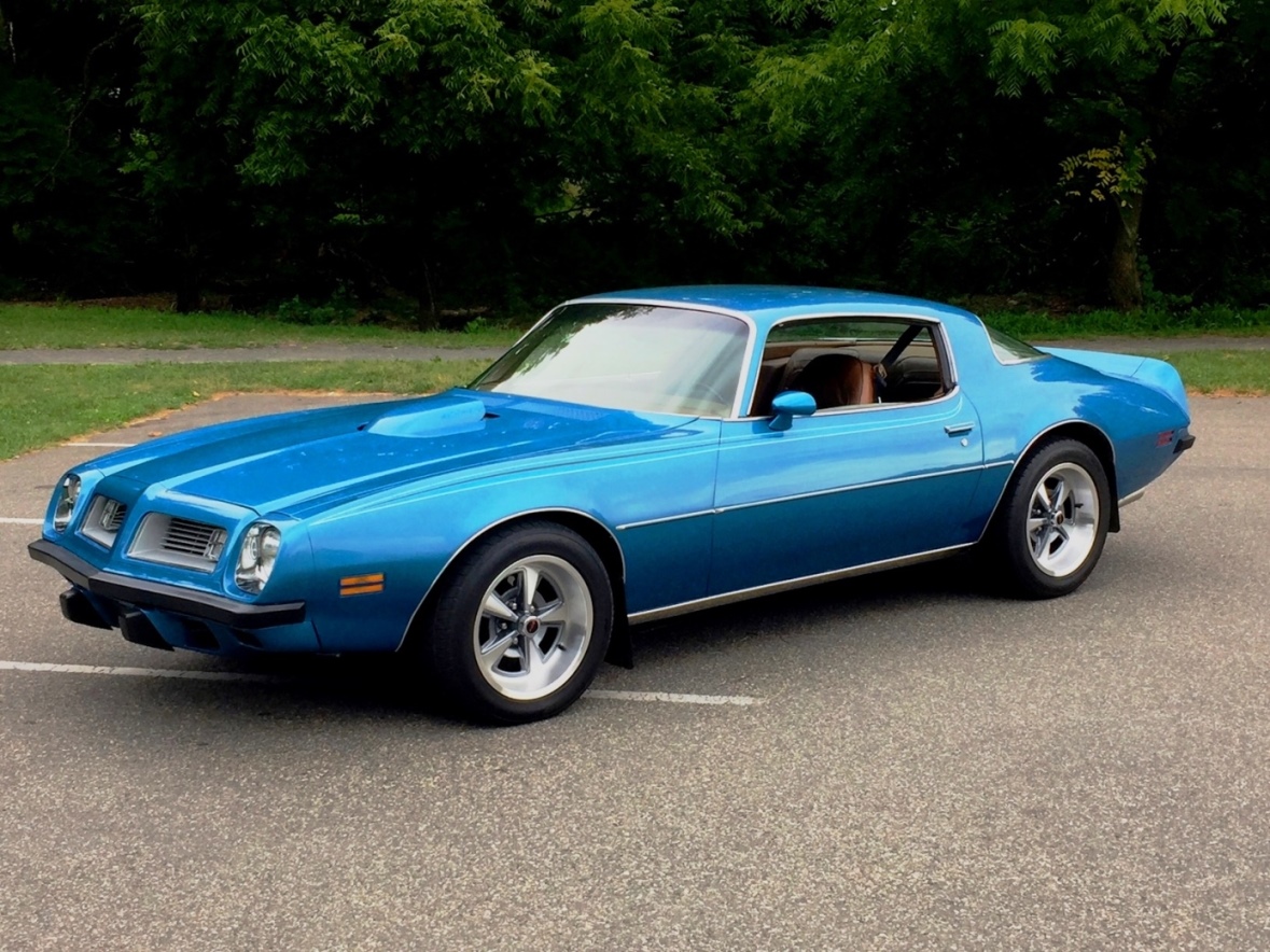

The stripes arrived yesterday and I put them on with some soapy water and a squeegy. The hard part is trying to get them symmetrically located on both sides. That took a couple hours. I think it worked out rather well in the end. Nice and subtle. The stripes seem to fade away in direct sunlight but in the shade they really pop.

  #552
Old 07-22-2018, 06:01 AM
Location: Santa Cruz, CA
Posts: 6,560
Thanks: 391
Looks sweet!

I think they add to the car without being flashy.
Looks great

Can you give a rundown on how you located them? Look great Steve.
--Nick

I used the lower window trim on the door as a guide and measured 2 inches below that line for the main section of the door stripe.
