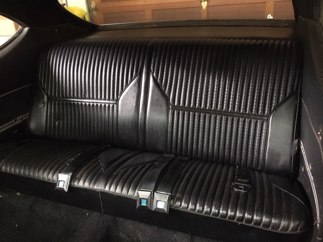

I am a little behind on posting progress.
I am moving ahead each day, some planning, some buying last minute parts, some renting a truck and trailer, some actual work on the car :-)
I connected the fuel lines and vent at the gas tank, and of course the left over hose is too short to connect the fuel pump as it is supposed to F&$@.
I installled the cowl screen and cowl seal, and hood stop.
I installed the back seat and peeped the front seats. (Installed one to make space)
So many little things to get right (or close to correct)
I pulled the tail pipes to dress the ends.
I think I can, I think I can.
Ryan W31.
PS: today I was really in a slump, I got lots done but my head and gut are getting freaked out. I need a good sleep and more progress tomorrow!!!
