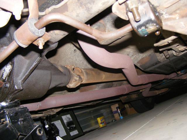

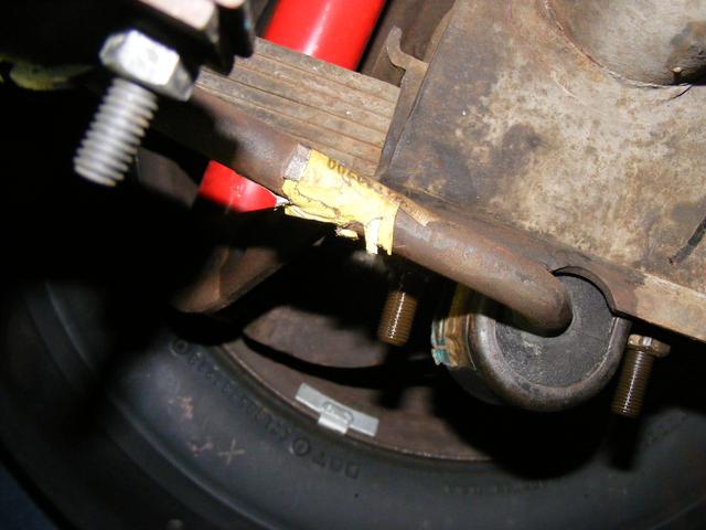

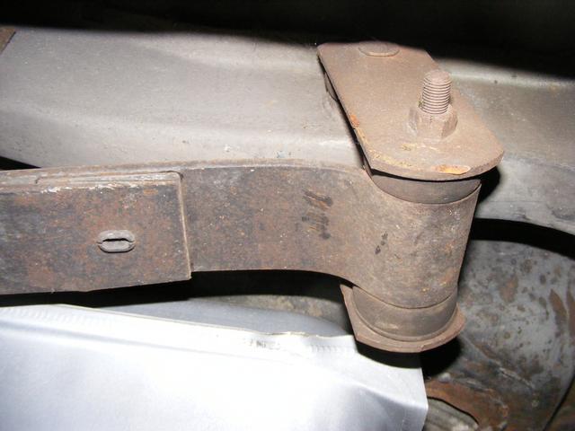

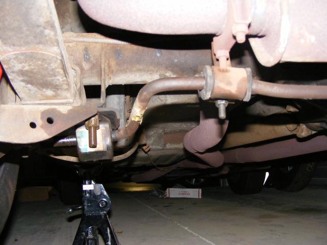

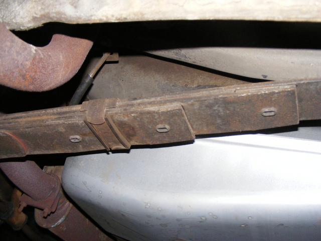

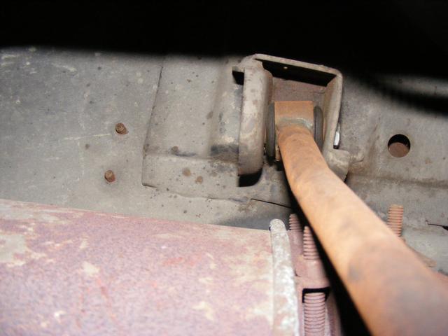

Hey All...I'm posting some photos of the F41 rear suspension on my 1974 Nova COPO 9C1 police car. I have posted quite a bit of info on the car in another thread in this section, and figured some of you might like to see this car's unusual rear springs.
I took quite a few photos of the rear suspension and was investigating if it was essentially the same as a Yenko Nova when I discovered one marked discrepancy between the two suspensions...Yenko Nova rear springs have 5 rear leaves and my car has 6.
The car has 120k original miles and was ordered by a Chevrolet executive named Rick Mahoney at the Los Angeles Zone Office for use as a high-speed police car demonstrator (it was a "Brass Hat" car...see documents in my other post). He used the car for 5 1/2 months and then sold it to Los Angeles County where it was used by the LA Sheriffs Dept as an undercover car at the West Hollywood station (it still has a shotgun rack in its trunk). It sat undriven in a garage in the Hollywood Hills for 32 years until I bought it in 2017.
It has many GM stickers still on its suspension components, including a yellow sticker on the driver's side with the part number "340399". The outer brackets have partial blue and white GM paper stickers, and the right support rod has a very faded paper tag that I believe says "Special" on it. The left support rod has a splat of dark green paint visible at the very bottom (it isn't visible in any of the photos, but it's there).

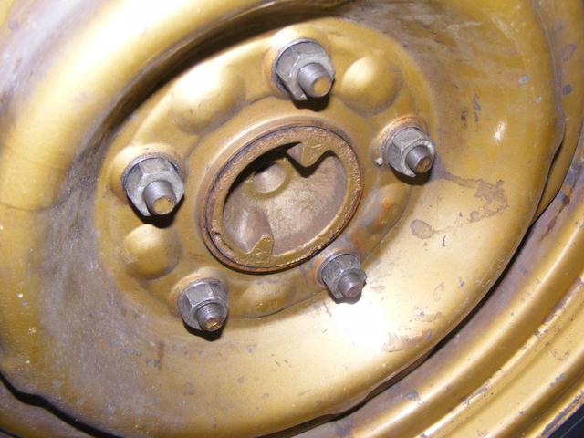

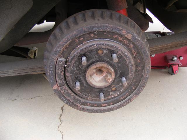

In addition to its mostly Z28 suspension components (from the factory), it also has rear drums and shoes from a Chevelle station wagon.
I am curious if these are possibly big block Nova rear springs (even though the big block was no longer available by the time this car was built). The car handles with virtually no lean in very hard cornering, and it rides very firm (almost like a truck when going over freeway expansion joints...no give in the suspension).

It's possible that these were one-off springs due to this car being a prototype as a police car. It is a Nova 4 dr. and besides having the F41 performance handling package needed for pursuit, it must also have the ability to place a couple large perps in the back seat as well. Don.

I wouldn't be so quick to say that there is no interest in this car. All though I have not posted any comments, I have been following every post that you have put up, and this is an interesting car to me. I have never seen the 6 leaf springs on anything before and it would be interesting to know how they were built. Please keep posting here so that those of us who are interested can keep up.

Big Gear Head, thank you for your interest. I plan to post more photos of the springs which will include their exact dimensions and the number of clips holding them together. I believe that they are one-off custom springs that GM probably put on all 17 of the '74 Nova police cars. The fact that GM went to all the trouble and expense to have them produced indicates GM management's desire to steal the cop car business away from Chrysler (which was the leading seller of law enforcement vehicles at that time). The fact that this car's springs were built at a GM plant and shipped (probably) from Detroit to the Van Nuys plant in less than 15 days (they had to be present on the assembly line right before this car showed up) is yet more evidence of this car's importance. Under hard cornering with this car there is virtually no lean. I owned a '70 Boss 302 in 1975 when I was 18, and this car is the closest thing I have ever driven to the feel of that car.

"Interesting setup, especially the rear spring pockets being deep enough to hold 6 leafs - and it still includes the spring pads on the top & bottom. Also, I noticed that the lower spring plates appear to be the mono spring design, and don't have the sway bar extension - which means that the bar itself is likely a little wider than the '70-'72 version. We pulled a rear sway bar out of a '76'ish 9C1 Nova about 20+ years ago, it was the correct width for a '70-'72. So, this setup is really cool...
I've had NOS rear bar setups, and confirm the green and blue paint treatment...."
