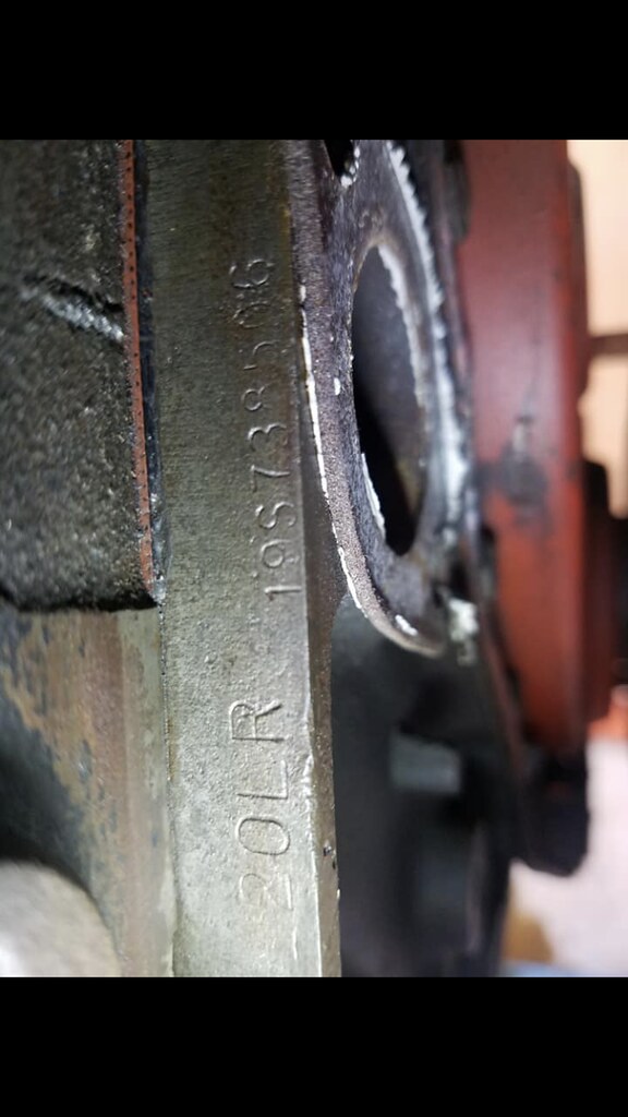

I need opinions on this stamp everything ive researched shows that the first number in the vin should be a 7 and not a 1. Is that correct?

1 is correct....
that's a late 69 vette,,,,built last day of production?

First digit of the sequential part of the vin is 7. 1= Chevy 9= 69 S= Vette. Is it a whole car, or just the engine?

Just the short block. So the stamping is correct then?

Yes it is correct

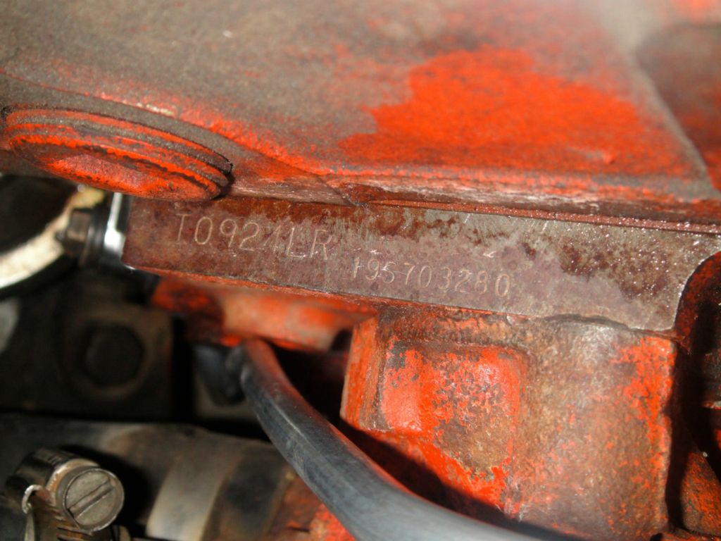

Yep that is correct. end the line 1969 L71 427-435hp 4speed Corvette block. Being that it was end of production it should be a "512" casting block. 69 corvettes earlier through out the production year used "439" or "270" casting 427 blocks. Here is a picture of a CCAS/Grenning Certified original 1969 L71 stamp pad from a early production 1969 Corvette.

Sorry for bringing this back, from that pic that i posted, what is everyones opinion on the legitimacy of that stamp?
