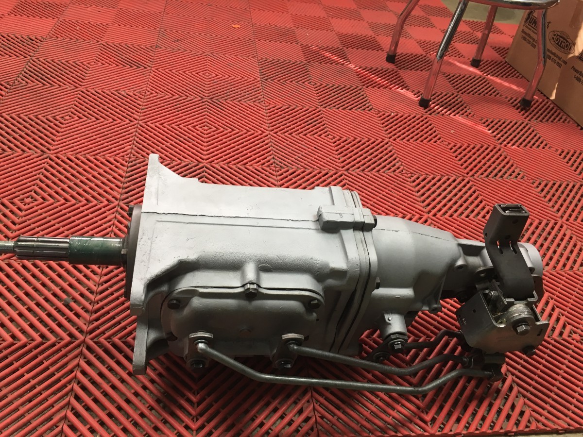

So with the engine now resting in place, we have since connected the clutch, installed the transmission and aligned the 3138 shifter with linkages. Today we cleaned up the original console, made the required carpet cuts and got the lower base installed with the wiring and oil pressure line in place. The console top was set in place near the end of the day and further cuts were made for the seat belts and seat tracks. I'll be finishing up the console, carpet and seat belts over the weekend with the rest of the interior to follow early next week. A mere 21 days left before the cars birthday and original shipping date of May 9th. Crack goes the whip.
Rebuilt Muncie M21 Trans with 3138 Shifter and Linkages
Mounted up but can't find the right bolts for the linkages. They're around here somewhere...gotta find them! (temporary bolts are in place for now)
Buttoning up the rear cross member and the transmission mount. Linkages are working great!

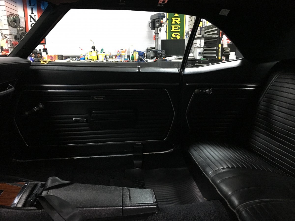

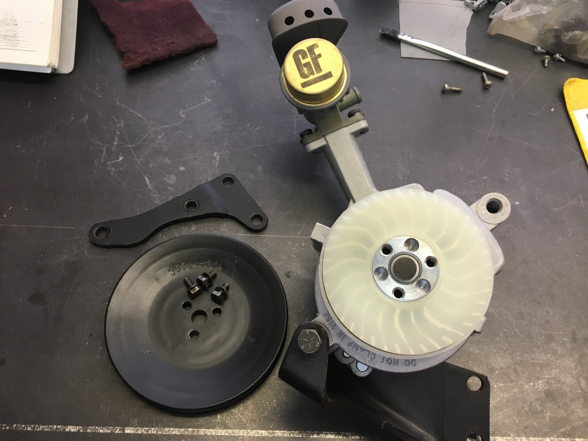

Been working hard with the interior the past few days while sorting out what seats to use in the car. I have a restored set of seats with new covers and an original survivor set but I'm really struggling between them as both have their +/- issues. A little more adjusting of the door panels is required but these originals are definitely going in. While back and forth with seats, we're also prepping bolts and hardware for the engine peripherals. Today we'll install the smog system, alternator, power steering, clutch fan and fuel lines.
