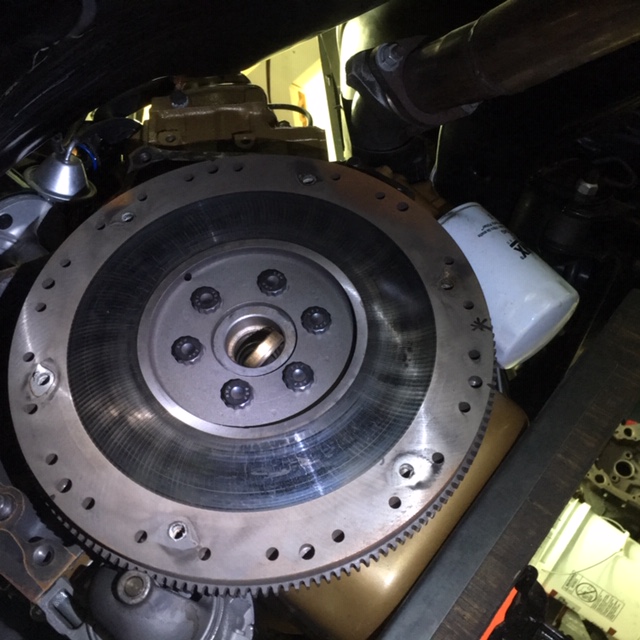

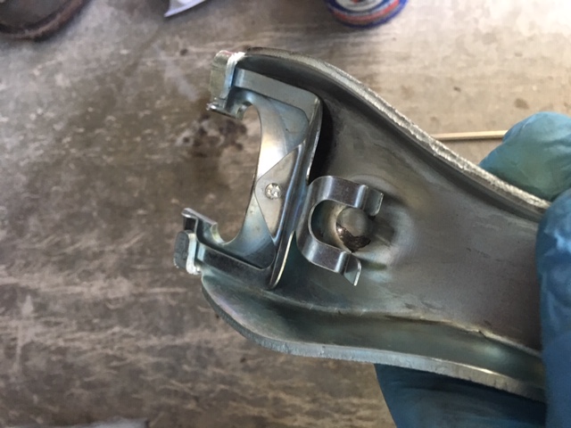

A few pictures.
I am pretty disappointed to see the wear on the clutch fork.... not sure how this occurred? Adjustment? Soft part?
Ryan W31

I had a new pilot bushing made at 1.383” OD and added a circlip back to the crank groove. Then I reinstalled the clutch, PP, Bell, fork, and....... the transmission!!!!!
Reminder: Add oil.
I pushed in the clutch and there is no binding, I was concerned as I had to draw it in due to my poor alignment tool.
Reminder: buy used 27 Spline input shaft.
I am headed back to the road soon.
PS: this clutch fork has wear every point of contact and all were greased and it has a whopping 500 miles :-(
Ryan W31

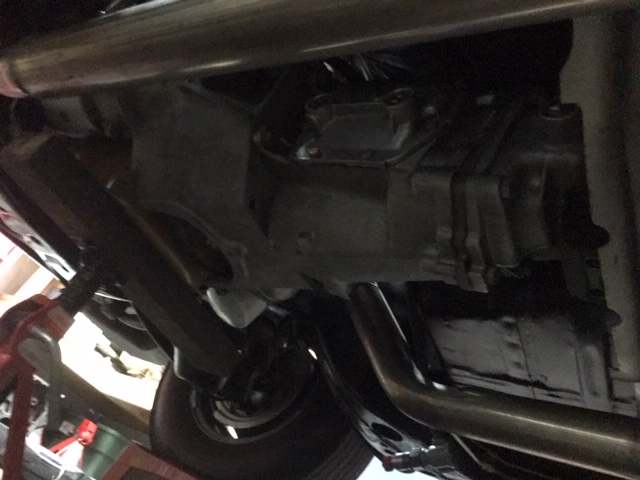

More time in the garage tonight.
I installed the speedo, driveshaft, crossmember, added oil, shifter installed and adjusted, adjusted the clutch a little bit.
Took it for a little test drive on the ramps and jack stands (she’s solid in the air and I didn’t make any hasty movements.
Trans sounded and acted and felt perfect. (Happy)
Note: I need to recheck oil after a little test drive.
