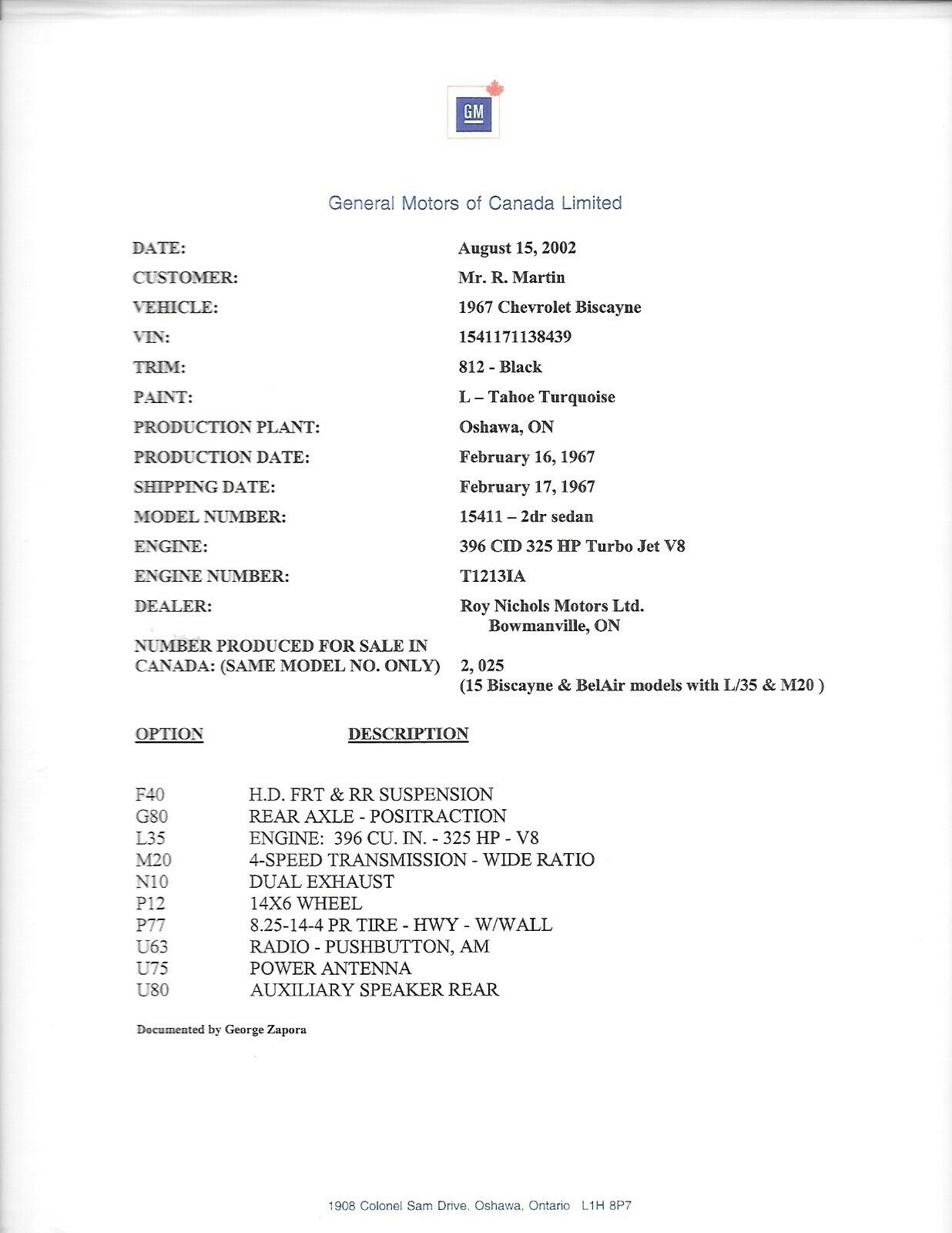

Got to be one of the nicest '67 big cars out there. Great colors, too. Opening bid is $40k...
Link to 1967 Biscayne 396/4-sp auction
1541171138439

Very very nice car, but not restored correctly at all to the way it left the assembly line in Oshawa.
67 Biscayne 2DR L36 M40 G80 K05 F41 #'S

The trunk should be all body colour, no spatter paint at all.
The posi decal is wrong, cdn cars used a unique one.
The firewall should be body colour, not black.
The cowl tag should have paint all around it as the tape they used did not cover the whole tag on the assembly line.
The 396 air cleaner should not have that sticker, it should have silk screened service info on it.
Its also missing the assembly line correct CDN rad cap. Granted they are a very hard to find item. They are similar to a AC RC15, they are stamped “made in Canada “ on them.
The pictures aren’t the best so that’s all I can see for now.

It’s also missing the CDN oil change service decal that goes on the inner fender on the dipstick side.
