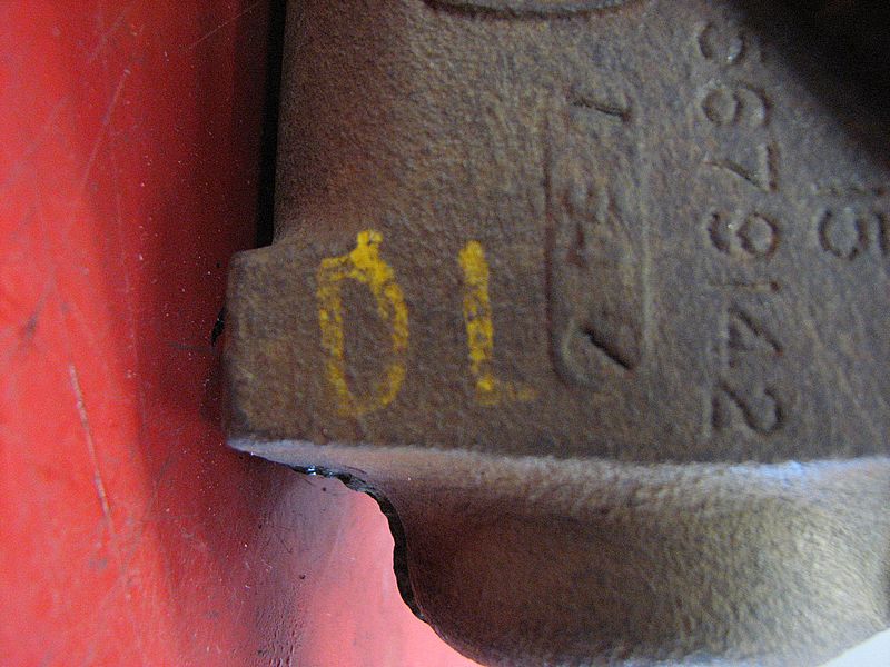

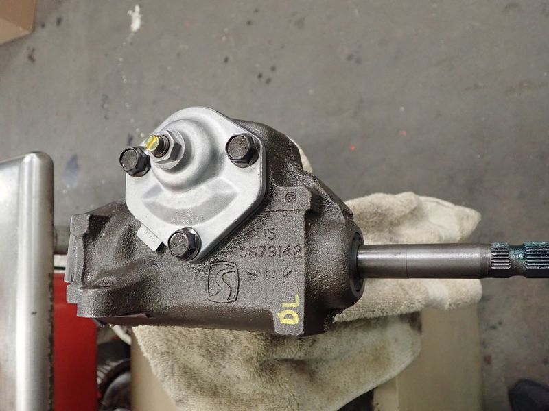

I am very confused. Several years ago I restored Mark Mitchell's Classic Copper 70 Z28 which had factory installed manual steering. On that manual steering box is the pitman arm casting number 3964881 (as seen in this photo). The 5679142 box, arm and all steering components were original to the car.
Enter 2020 and a new Z28 restoration on a Cortez Silver RS/Z28 which came to me with power steering but per the buildsheet it should have manual. Great, so I have a correct 54679142 box and took the 3964881 that was mounted on the power steering box off to use on the manual box but was confused because I know that the pitman shaft is a larger diameter on the power steering cars than on the manual. Sure enough, the 3964881 pitman arm that I have will not fit on the manual box shaft but has the exact same part (casting) number. What gives?

I think what we will find out is that the forging number is the same as that was the length, but the part number was different which determined the broached hole size.
The Z28 used the same manual steering box as the 6 cylinder Camaros. They quickend the ratio by using the longer 8 inch arm. The power steering cars used the used a specific steering box and the 8 inch pitman arm with a larger broached hole. The steering linkage is the same for manual and PS Z28's. Same with the idler arm. The non-Z28 PS cars used a shorter 7 inch arm with a different steering link that offset to the front to comp for the shorter pitman arm.

The really odd part is when I do a search on the 3964881 it ONLY comes back as a PS arm and is never listed for a manual and yet as can be seen in my photo, there is one mounted on a manual box.
Dave, I don't think the "M" stands for manual as doing a little research I am hearing of several different letters stamped there. On the 3964881 arm that I have that came in on the latest car there is no letter stamping at all.
