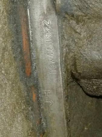

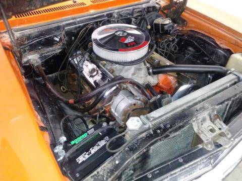

Looks like an interesting car...deck stamp appears to be legit. I have some concerns about the front end; headlite bezels have been changed...there is no rubber radiator flap and i can't see the series of little holes that should be on the top of the radiator support for the pins that hold the flap...looks like there are several threaded holes...that would indicate a support from a small block or 6cyl car....perhaps pieces were changed when the nose was painted or..??
The ad mentions a 3.31 gear with 4.10 now...the default gear for an L78 car is a 3.55...3.31 would have been a special order.
A personal inspection is in order if you are serious.
