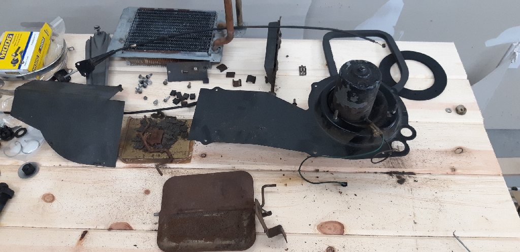

So it appears I'll be doing a few more things on Crusty to get her ready to head out towards the end of next month. In addition to the front suspension, I'm going to tackle the rear suspension and in the middle of that, the heater box self destructed! In between bolting up front end parts, detailing the emergency brake and pedal quadrants, I tore the box down and will start renewing that contraption tomorrow. I can't add anything else to the car on the front since it's nose heavy right now. And being on a 2 post lift, I don't need to see what would happen if the mighty Cuda became a lawn dart!

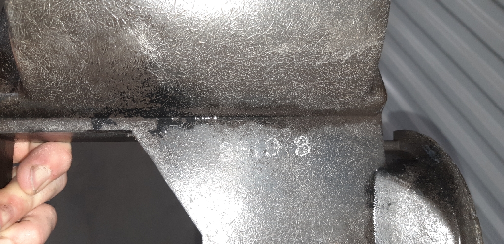

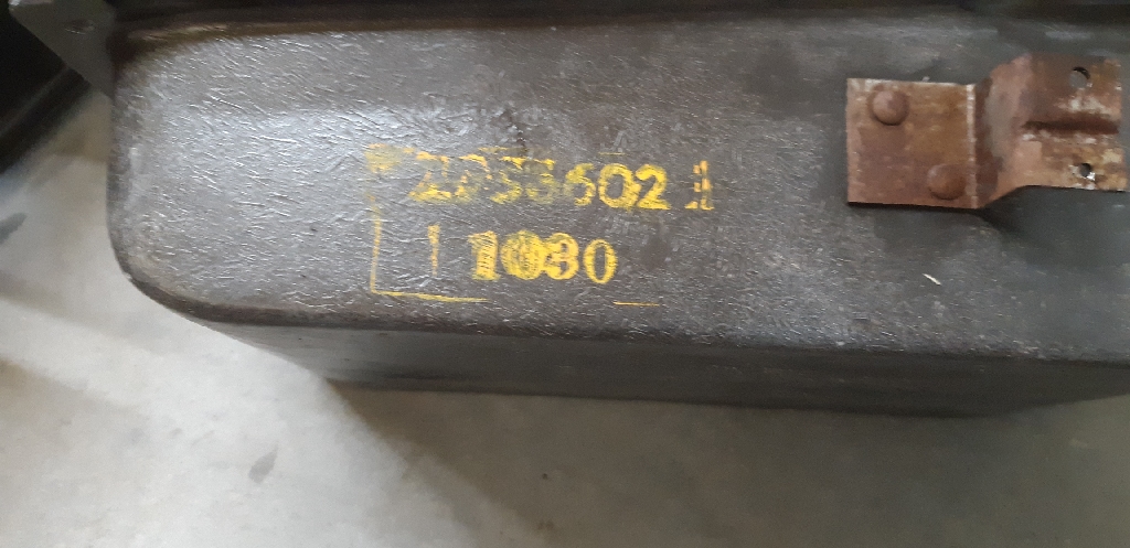

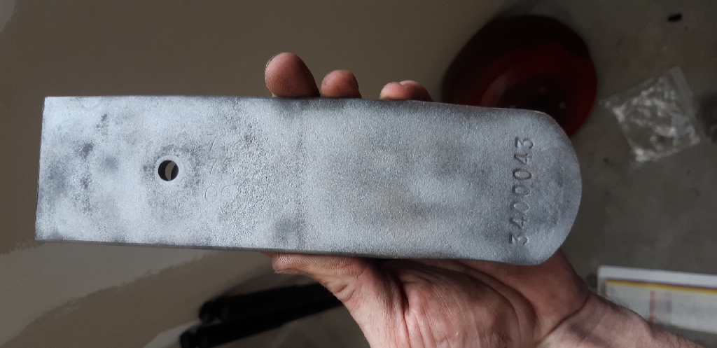

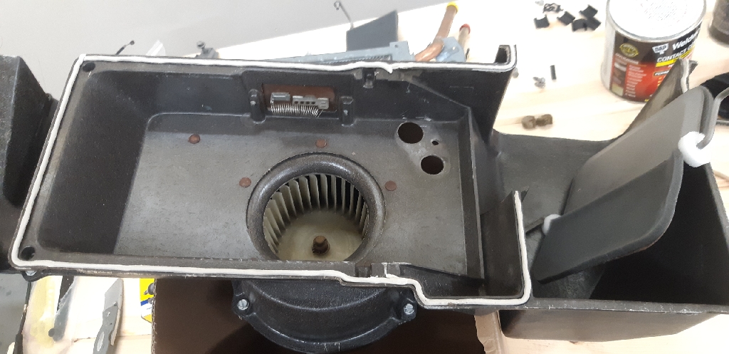

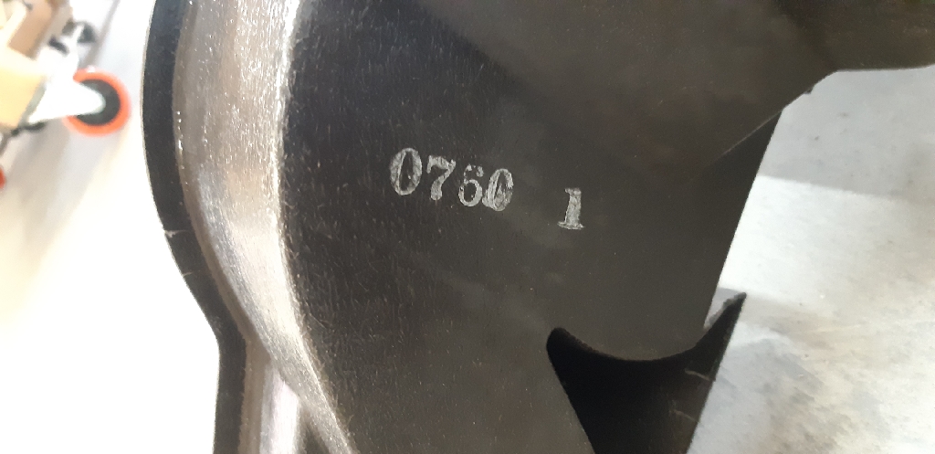

Detroit Muscle makes a great rebuild kit for the heater boxes and with the new foam in place, it was an easy reassembly. I first washed the box with soap and water along with a brillo pad. That removed all the mold, dirt, and funk from the box. These boxes are unpainted so just a good cleaning is all it needs. Interestingly, there are three date codes on the box: the half piece shows the 351st day of 1969, shift 3 (I think that's what that 3 means), the main box has an ink stamp indicating there 76th day of 1970, 1st shift, and the final assembly date with part number showing the 103rd day of 1970. Neat stuff and I was able to save two of them. The third is sort of ghostly, but it's still there.

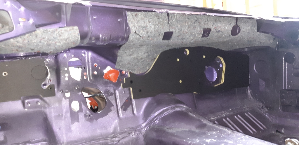

So back in the car it goes along with the pedal quadrant (Steve will add the pedal pads and new accelerator pedal/spring....I mean, he's gotta do something! ). Meanwhile, like a bad 70s adult flick, it's onto the rear end!
