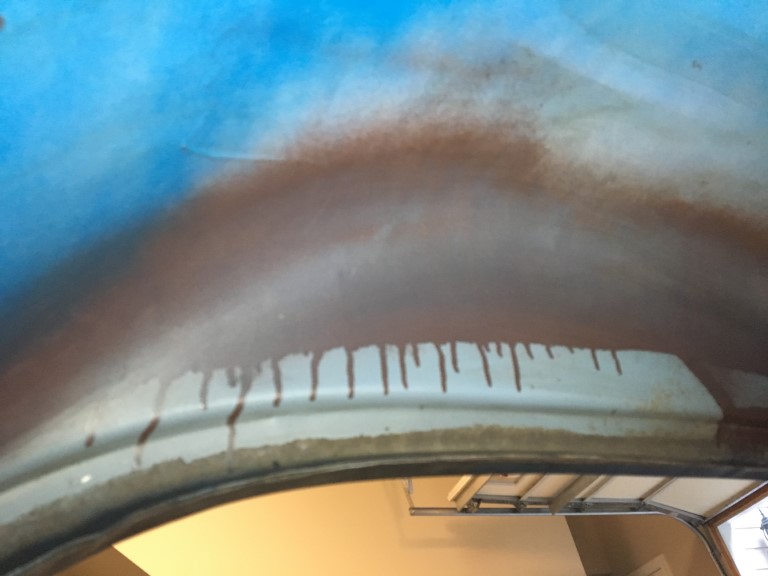

Originally Posted by CamaroNOS View Post
It really dissects the assembly and painting process in great detail.
Originally Posted by John H. on CRG
Assembly Process
In the first prime booth, the entire body, inside and out, was manually sprayed with primer, and confined areas subject to corrosion were given a second coat of heavier primer material;
Was the first primer gray, and other in corrosion areas red? Might explain this. I haven't asked my painter to reproduce the runs ...
Rob
Attachment 172273
Rob, although reports say that all cars received a gray primer-surfacer before being baked, I've been told by multiple people that different color primers were known to have been used between light and dark colored cars and have shown up on many survivors? Many of the dark colored cars have been found to have a red primer used under body color in some areas? Not sure if that was from the beltline down or just the wheel areas???
