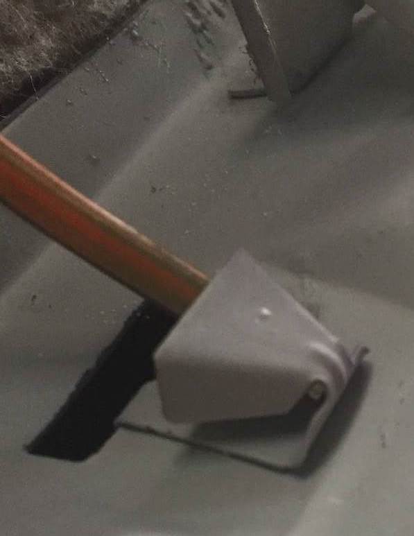

Working on the old gal this weekend. I was going to put in the headliner today but it turns out I am missing a single headliner bow clip. UGH! This is the little doo-hickies that the end of the headliner bow sits in. Forensic analysis indicates that this one has been missing since before paint because the primer is covering its mounting location. Anyone got a random one in their tool box? They make them new but I don't need a set of 10 for $25.

here's that clip I need.
