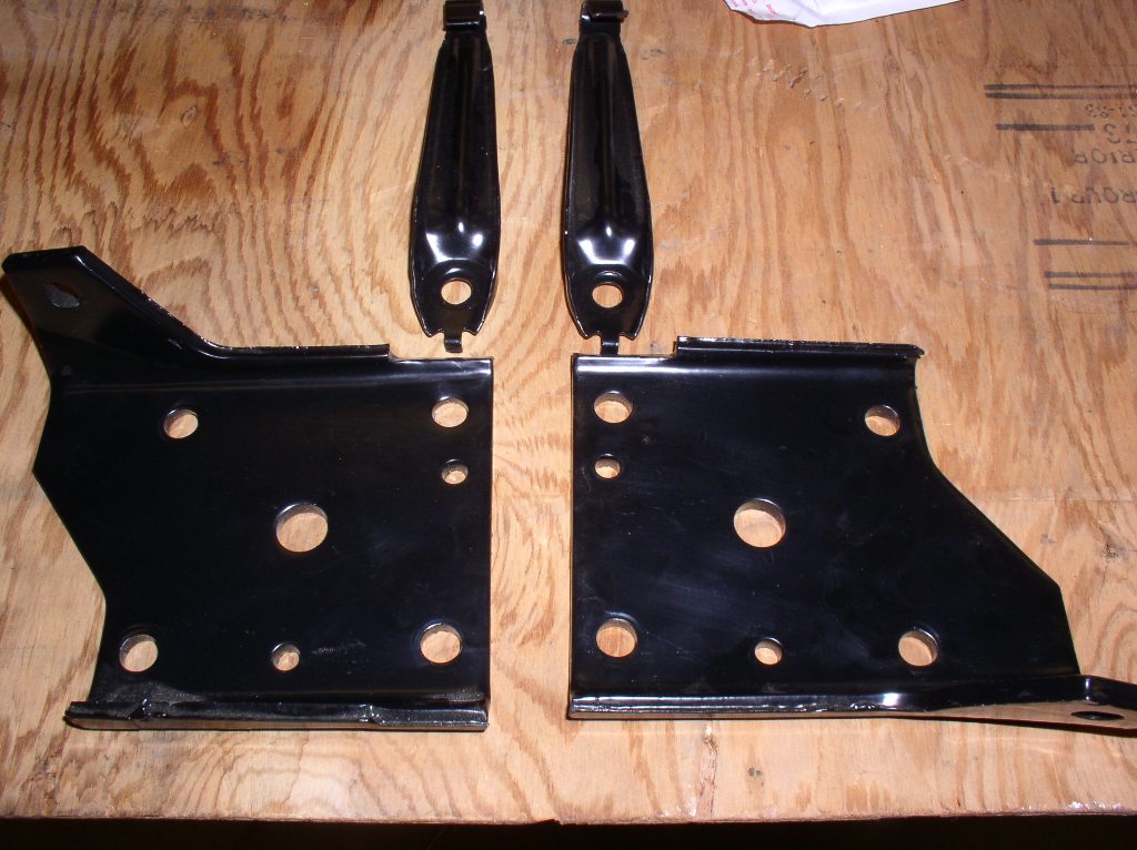

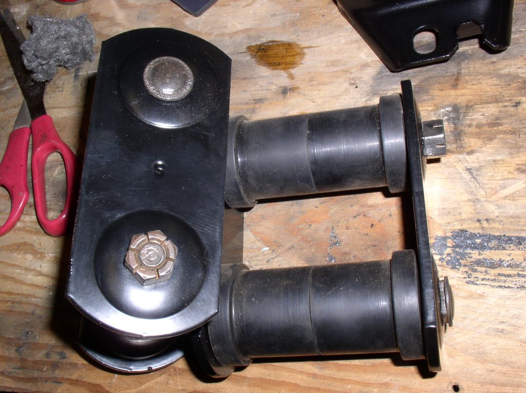

The car being from Tucson, all the hardware & brackets were in great condition. Original "S" shackles & bolts/nuts & NOS bushings. Original spring pockets. Original spring plates & brake cable guides. I also have NOS spring pads. All powdered back to original color. Managed to scare up some original "832" rear shocks....Joe
