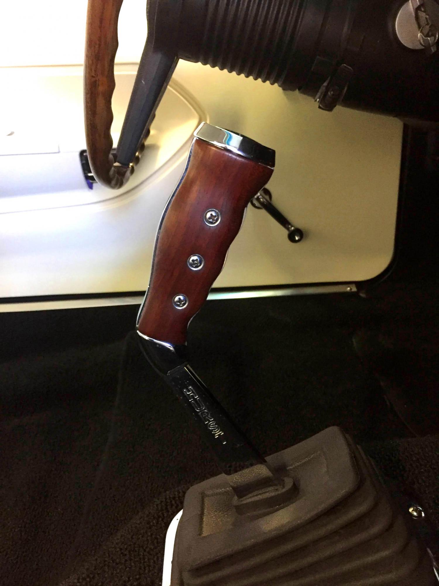

I also installed my old set of wooden pistol grips that were previously on my orange 1971 Six Barrel 'cuda ragtop in 1985, and then on the red 70 Hemi Charger R/T-SE in 1990. When I sold that car in 2013, they went into a box in the closet. I bought them at the 1985 Mopar Nationals back in the day. Some eccentric dude from Colorado hand-made them out of Cocobolo wood with some crazy wood-working duplicating lathe. I have an extra unfinished set that still needs final sanding.

I bet those don't rattle in 2nd gear at 3500 RPM
  #848
Old 11-27-2020, 04:03 PM
njsteve's Avatar
njsteve njsteve is offline
Join Date: Nov 2003
Location: NJUSA
Posts: 8,325
Thanks: 8
Thanked 2,642 Times in 819 Posts
The trick is to put a couple dabs of RTV on the chrome before you sandwich the grips to the handle.
I remember that buzz/rattle from the old days! And when the top bezel would get loose, it would add a nice ensemble tone to the jiggly sound of the loose plastic grips.
Ahhhhh, the memories are rushing back now.
