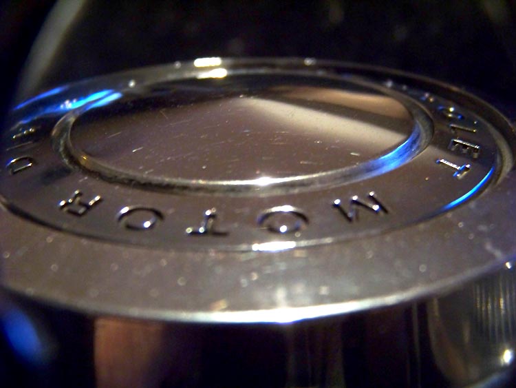

I am going to check the flute design inside the caps, however the caps I have found on 68-69 survivors and original cars in storage for many years are much more defined, the edges are sharper and the VERY center of the cap ornament is actually a shallow cone - if you lightly run your finger over the center you can actually feel the point, the later caps are "softer".
IMHO IT appears like someone buffed an original ornament and made a mold from that. Rounding the crisp definition and thus the proceeding batches were not as crisp as the first.
I believe I have a damaged cap with the sharp definition - I am going to section both and then the differences will be obvious if they are not currently.
FIRST PHOTO is the shallow cone center
Second Photo is the less defined dome
~JAG~

More photos -
FWIW of the sharpest most crisp caps NONE have a mark indicating they were manufactured in Canada.
Two have 2 flutes internally and one has a single flute, these 3 caps have the same internal structure other than the flutes with the part number and other numbers in the same font, same place, as well as the same recesses etc
The other cap was manufactured in Canada and has additional marks with a HB and recesses, it wax reported to have been purchased AFTER the car was wrecked in 1973.
FWIW The caps on my survivor 71 Corvette are all manufactured in Canada and have 2 flutes.
Who has a 68 Z with the original derby caps?
I would like to see what they look like inside...
