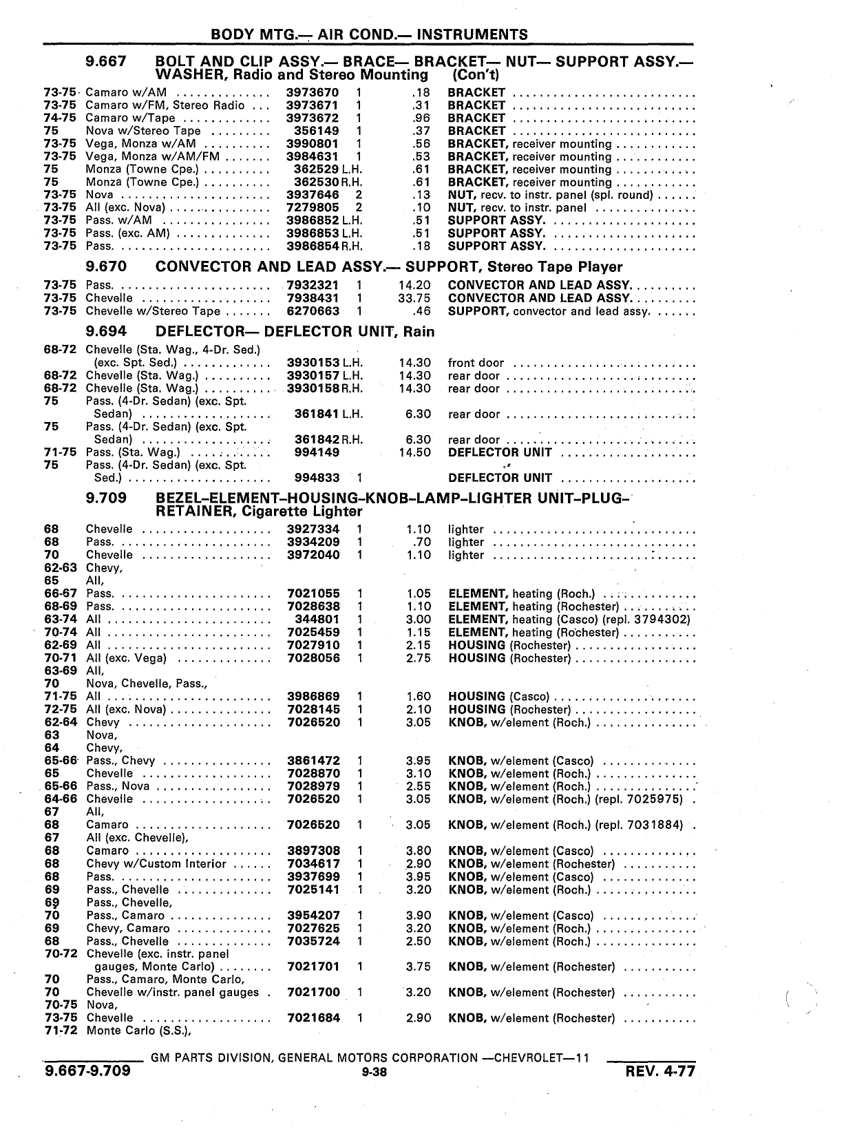

I didnt think the Camaro had the large knob style.
I thought the all came with the small one like this:

I believe the large knob was used in 69

Hmm. Both mine have their originals and they are small. I took that one in the pic out of an original 69 that was in a junkyard back in 1981.
I think the larger knob (same size as the headlight sw knob) was on Chevelles and Impalas
1969 Camaro RS/SS Azure Turquoise 1969 Camaro Z/28 Azure Turquoise 1984 Camaro z/28 L69 HO 5 speed 1984 Camaro z/28 zz4 conversion 1987 Monte Carlo SS original owner |
7067625 is the part number for the 69 Camaro knob. Parts book shows it as Camaro and Nova only. If you look that number up, its the smaller knob.

Thanks Jonsey
You made my search much easier now I know what I’m looking for.👍
