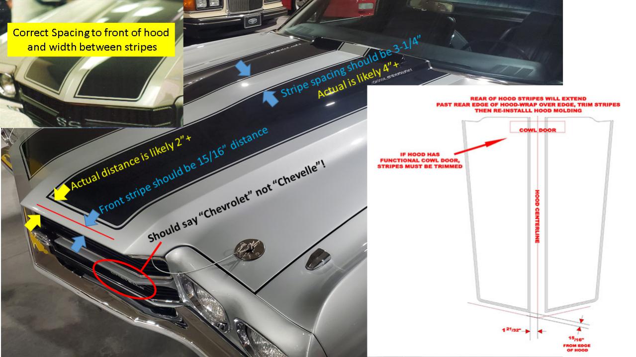

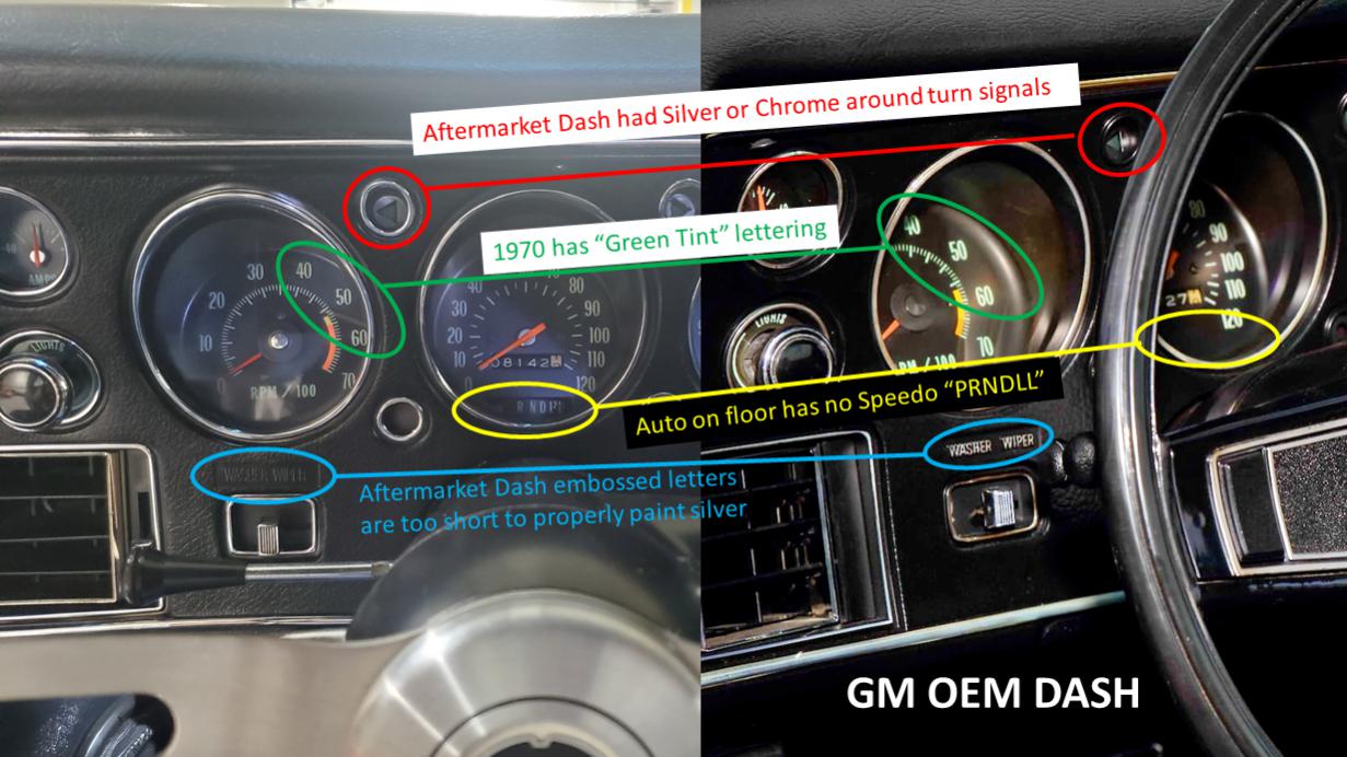

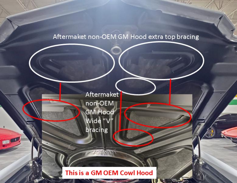

I thought that I had found my dream car until I looked closely...supposedly a one owner full frame-off restoration with only 7K miles in 2017 and now a 2nd owner! Amazing all of the aftermarket parts required for a car that was in "storage" for 45 years.....and for close to $100K....not! Interior seats can go bad after sitting, I can understand, but things like aftermarket hood, dash/gauges, wrong intake and the list goes on, see pic's below:
