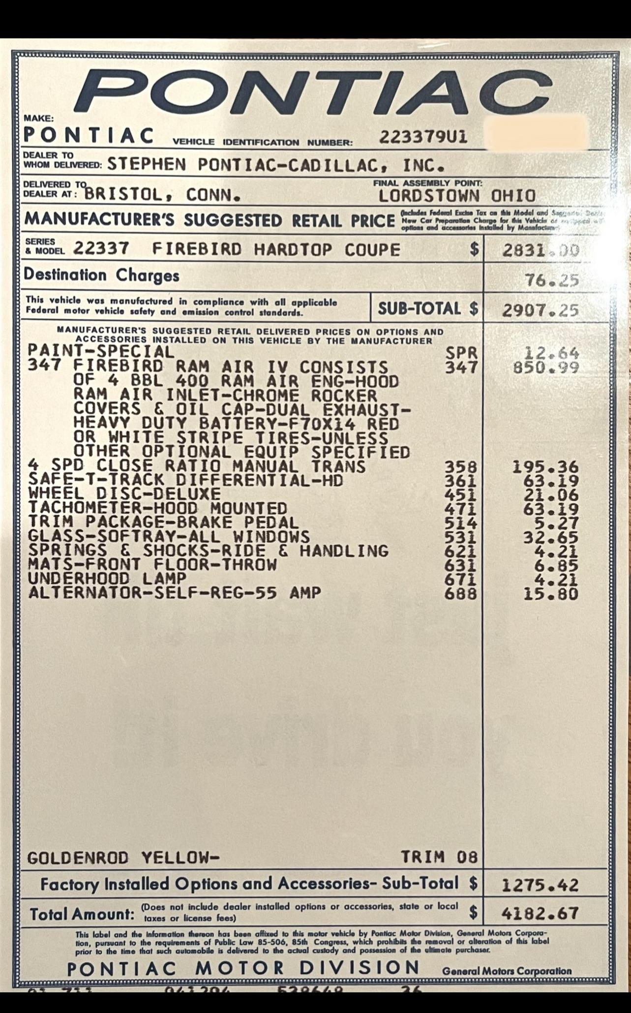

Here’s my window sticker
Just done a little different on the paperwork

This is a window sticker of a car I used to own. Another expensive RAIV that was optioned very well.
