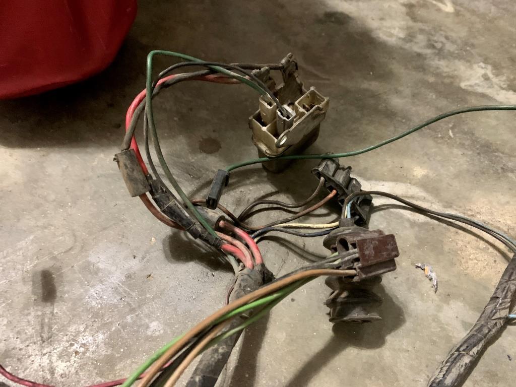

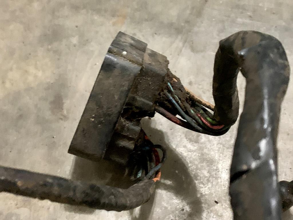

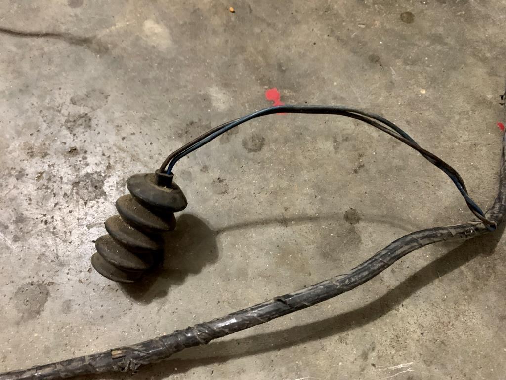

Now that I have some floor space I decided to pull the harnesses out for their cleanings. First up is the headlight harness. As you can see it was pretty dirty but the results are surprising and I feel the harness is in very good shape. I will need to replace one plug connector and a plastic clip but I should have enough old harnesses to replace the items needed. I hope.
Photos 475 - 480 - Before photos of the engine and you will see the engine harness attached as well.
Cleaning was pretty straight forward. As you can see the black spray bomb in certain areas. I will do a final wipe down with xylene before installing but just want to get the majority off while I have the opportunity. Citrus degreaser, green Scotchbrite pad and a microfiber rag to wipe it down.
Photos 481 - 487 - Current stage of cleaning. I will continue cleaning the bulk head connector and continue on to the engine side of the harness.
