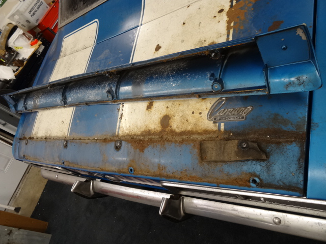

Rear Spoiler removed and deck lid top cleaned and waxed. Notice factory tape covering unused holes. .. D

More spoiler... D

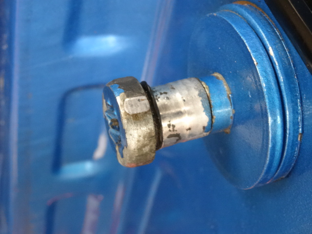

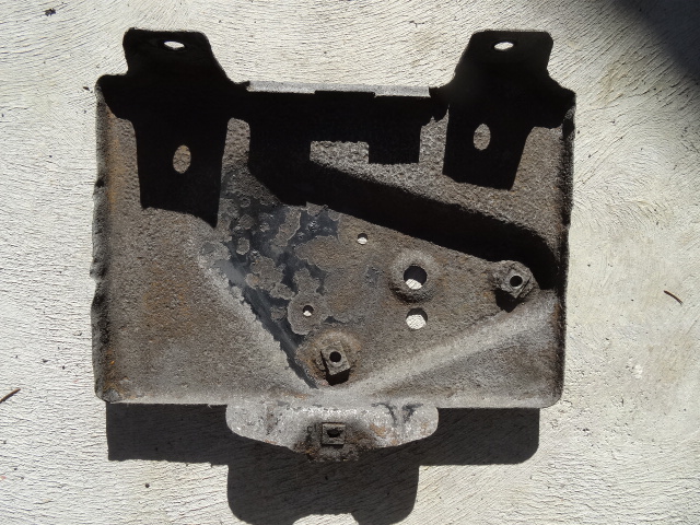

Battery tray pitted but I will strip it, treat it, and shoot it. Should be fine.
Driver side door striker showing very light wear. Area cleaned up nice. .. D

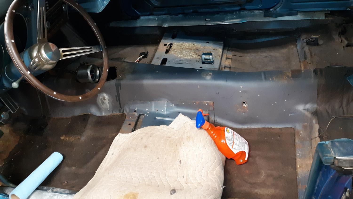

403 on BH Interior steel in nice solid shape. Interior seats/panels etc, faded but workable... D

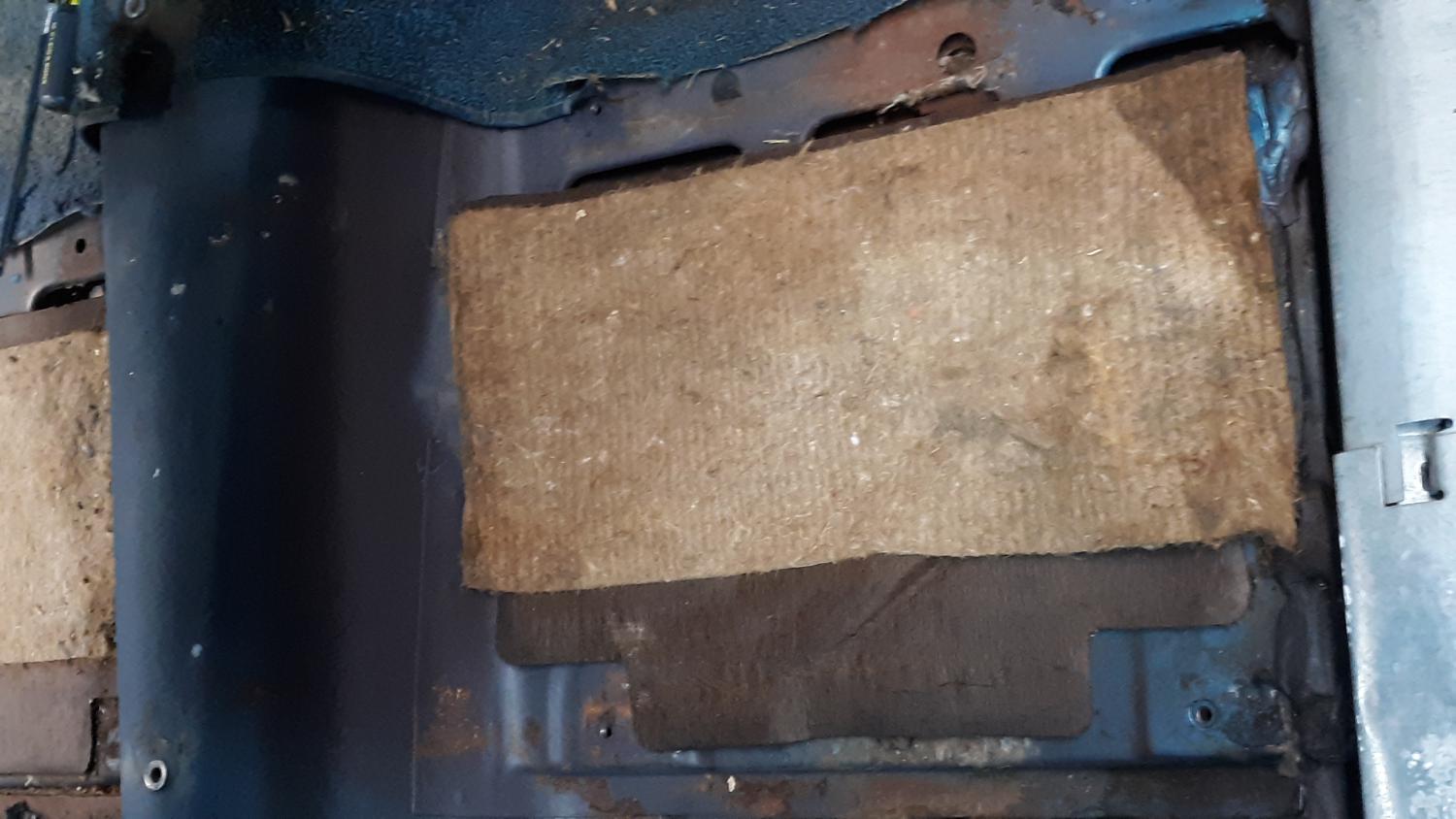

More Interior.. D

More.. I pulled some of the pads out as they were barely attached. I will put them back down with some spray adhesive later during reassembly. D

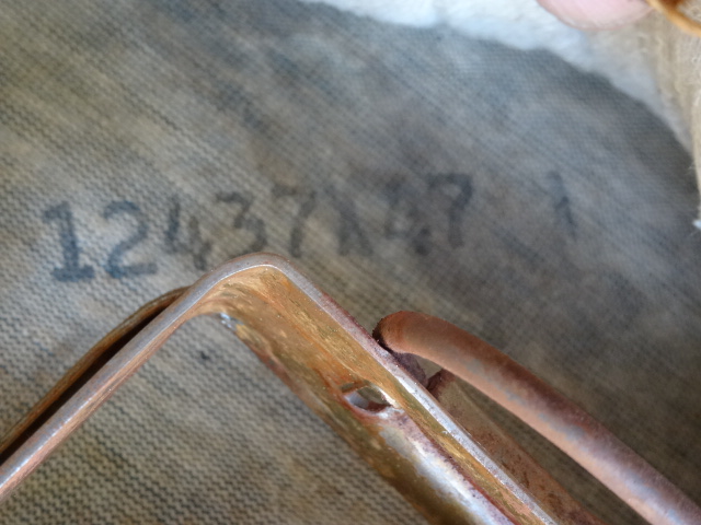

Partial V8 VIN and maybe and interior color code? Also inside door panels. D

The drivetrain codes were written on the broadcast sheet. The scheduling clerk then entered them to create the POP.
One of those two people wrote / used P8E18, either out of expectation that would be the code or misreading it.
That's not the original alternator - K79 was n/a with Z28. Someone swapped the pulley.
12437 is just the model number.
