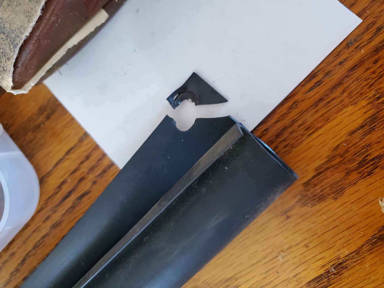

So I took the car out yesterday while it was cooler here to do a shakedown drive and ran pretty well except for the carb - secondary's just dump and bog it down , need to play with spring and set screw, but temp was fine with a stainless flex fan, even without a shroud on it. car floats around needs upper control arm bushings as the age has taken its toll and I have another plastic weld to attempt.
