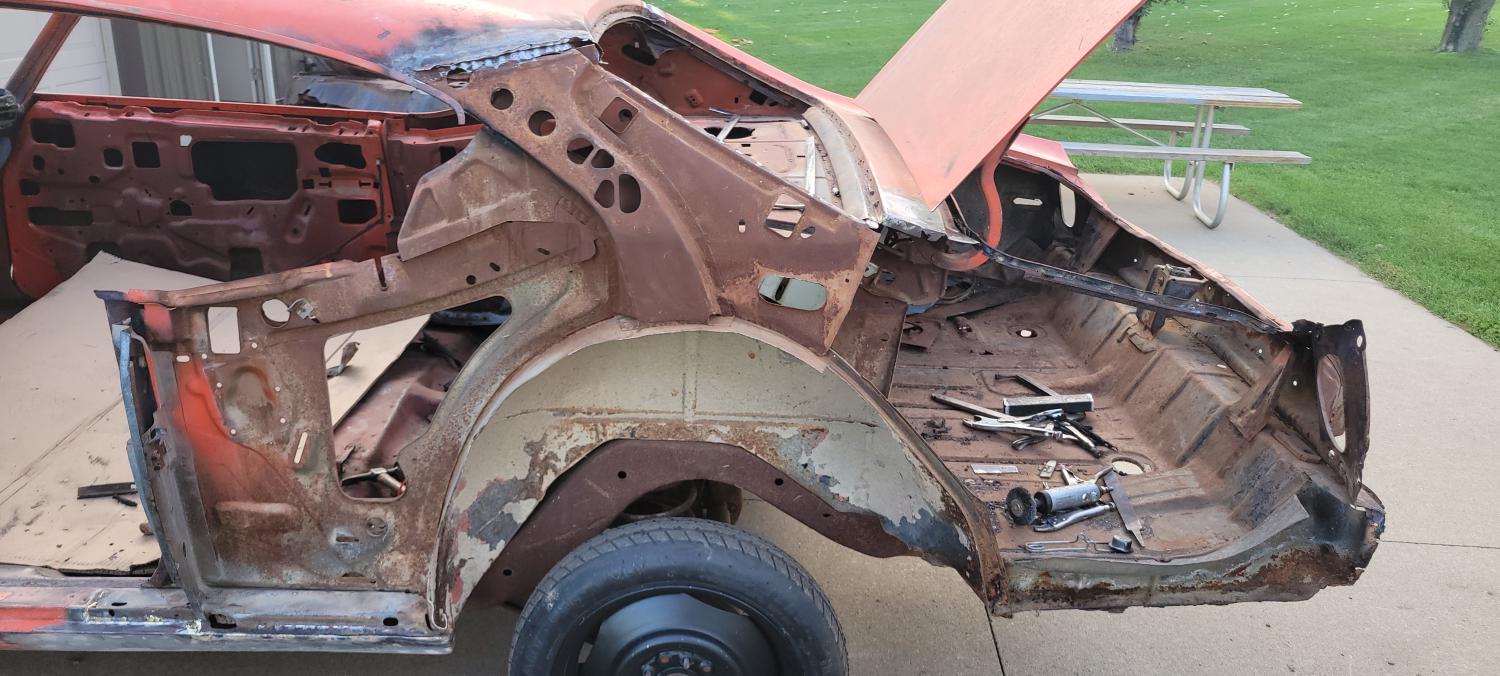

Location: Washington, Illinois
Posts: 280
Thanks: 84
Thanked 1,386 Times in 209 Posts
Default Passenger Door
Both Doors are in immaculate rust free condition. Sadly I could not save the Drivers as the original damage from an accident had the door frame too out of shape. The passenger side however had the damage only isolated to the top of the door. There is alot of transition body lines there so pretty difficult to bring those back. I replaced both the inter and outer structure/skin. Came back together pretty easy.

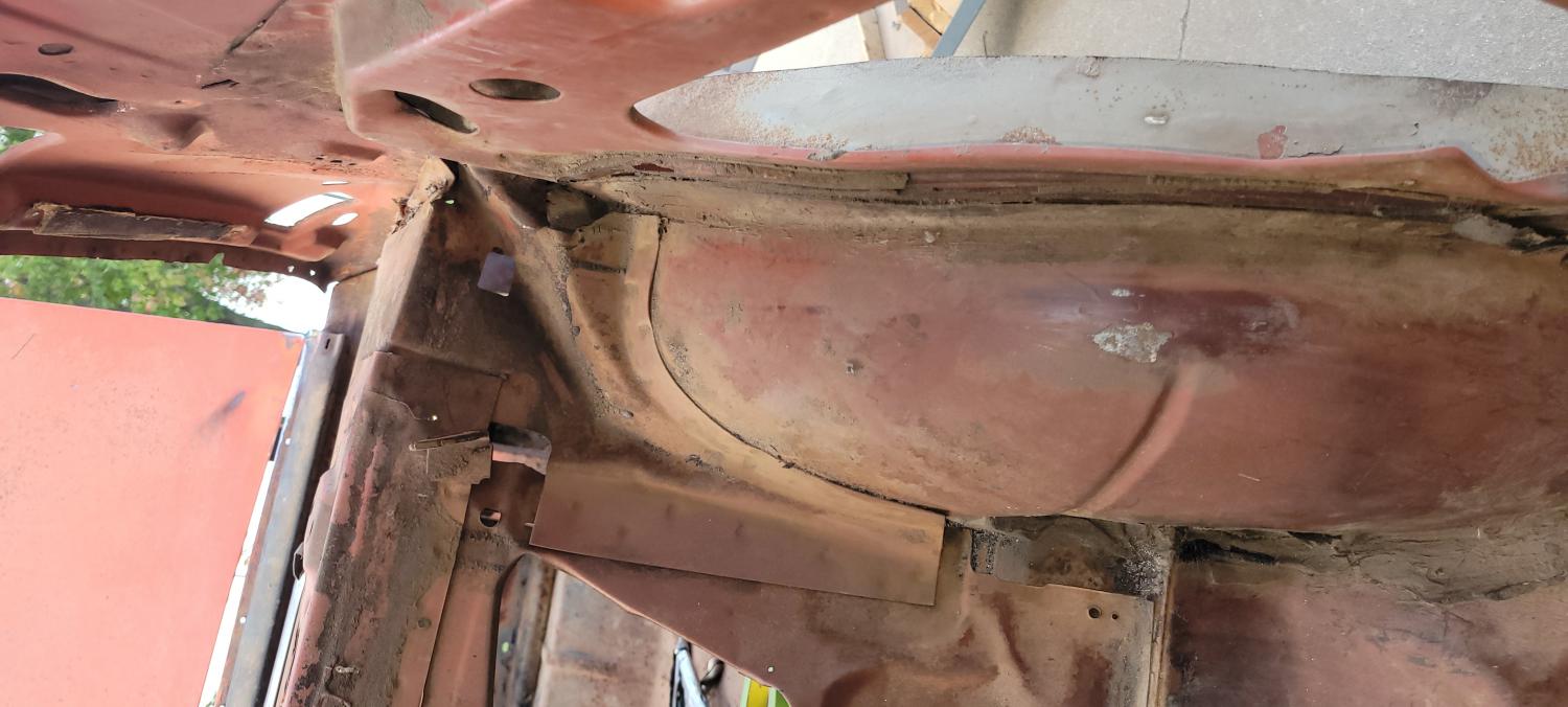

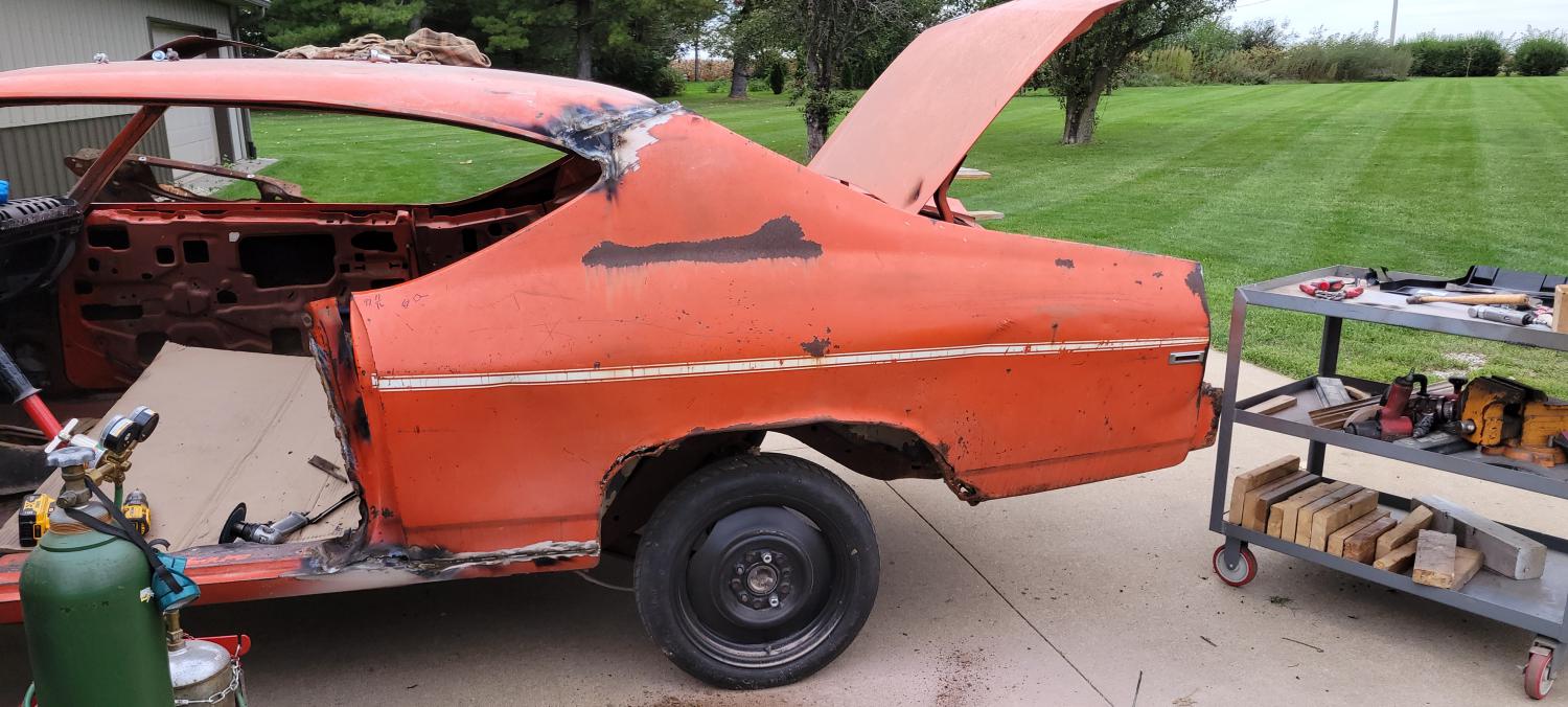

Old 10-13-2023, 01:27 AM
OneStopRestoration OneStopRestoration is offline
Posts: 280
Thanks: 84
Default Drivers Quarter
The drivers quarter had also sustained damage at some time. Inner wheel house was still crinkled and then beat back out with a mallet. Both the inner and outer wheel house was pushed into the trunk some. Gonna have to take alot of original pieces out including the connection to the package tray to be able to gently push it back out into proper location before putting on a new nos quarter.
