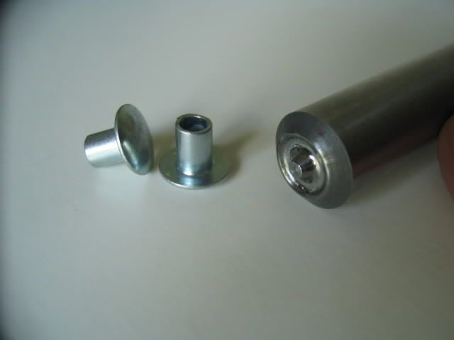

Does anyone know if the rivets and tool are still available in this old thread? I tried sending a message a few days ago through this site, but just checked, and it apparently didn't go through. The Nova Research email has also been disabled according to that site. Thanks

Old 02-21-2024, 01:49 PM
Posts: 20,897
Yes.
https://www.mcmaster.com/products/tu...llation-tools/
L_e_e (02-23-2024)

In case you want to "roll your own"
Made mine on a CNC mill using an old transfer punch, but a lathe may work.
The rivets I got from my local TrueValue hardware store in the Hillman stuff:
https://shop.hillmangroup.com/ccrz__...78&cclcl=en_US

I made a tubular rivet tool out of an old punch on a lathe too. I also made a fitting to go in this rivet tool to get to areas where a punch was too big and you couldn't use a hammer to peen over the rivet.

Hansen Rivet Co is a good source also.
https://www.hansonrivet.com/
