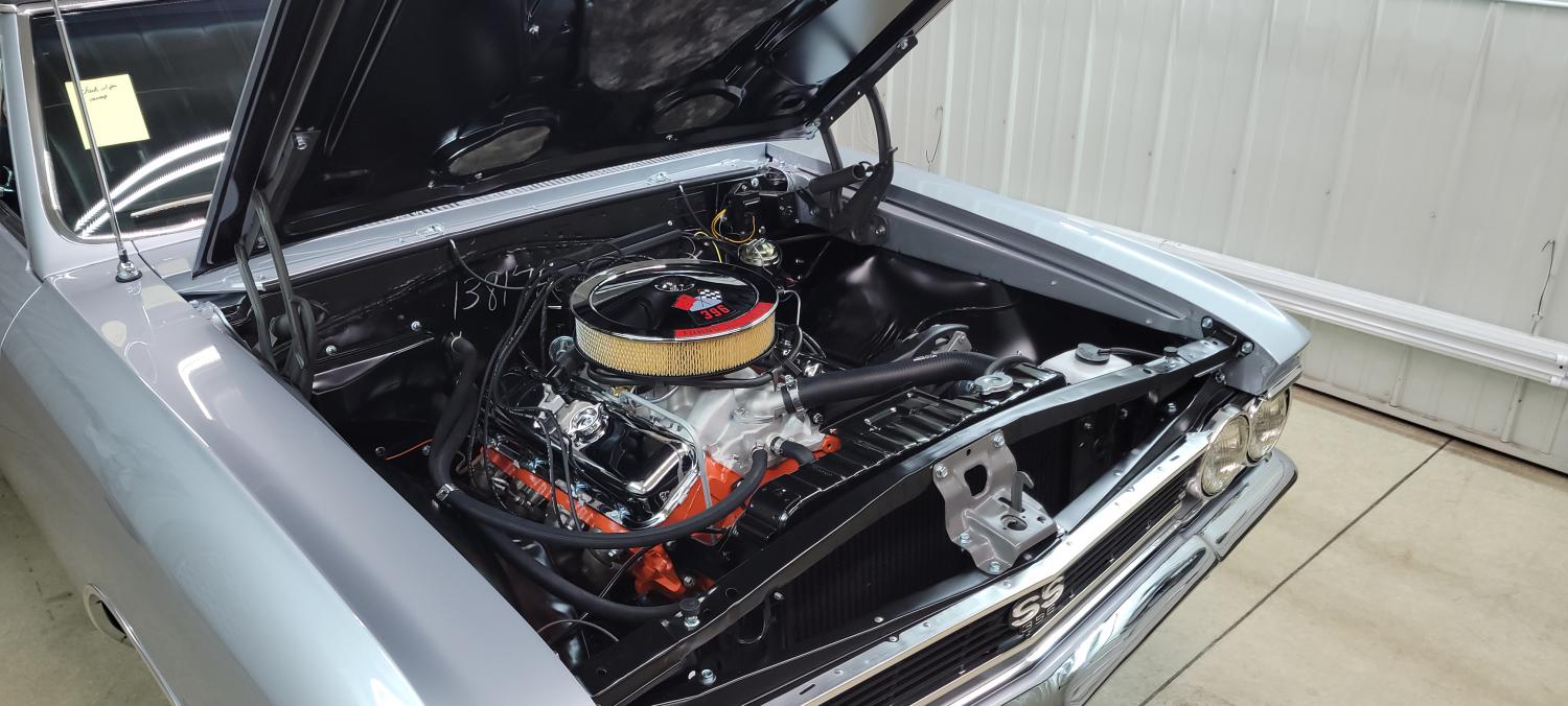

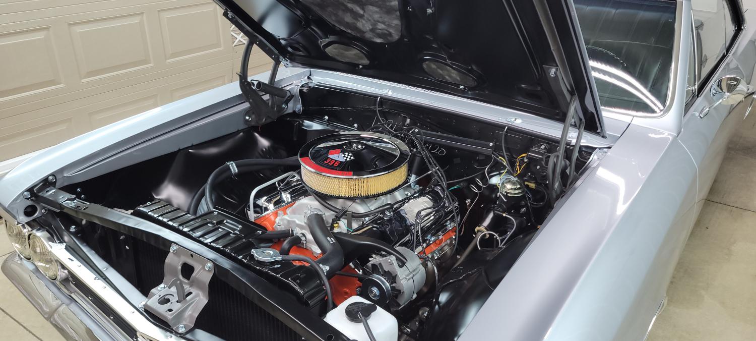

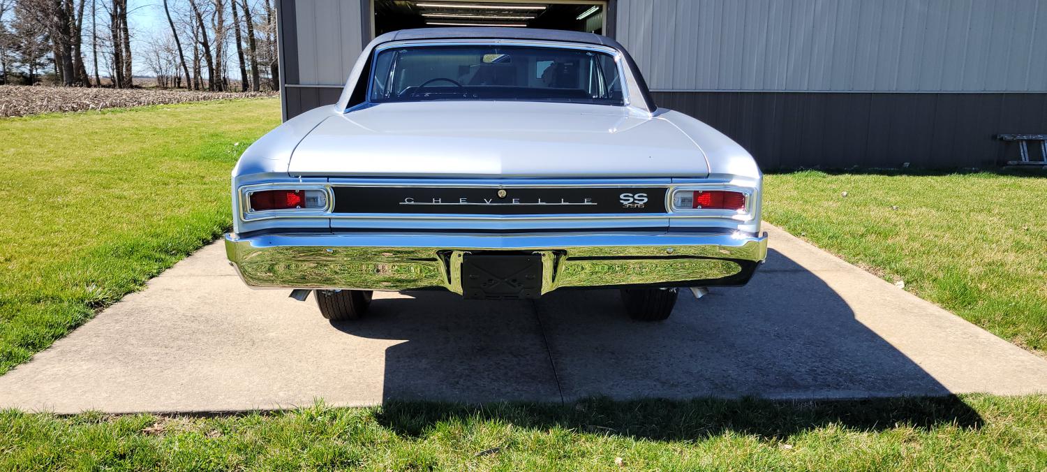

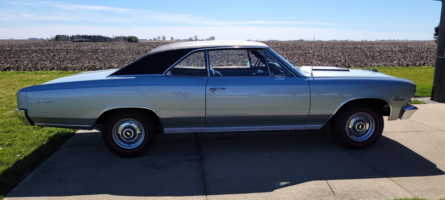

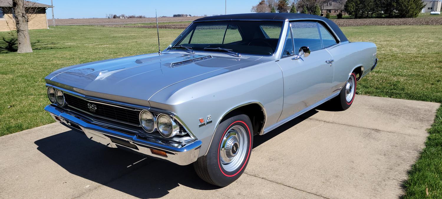

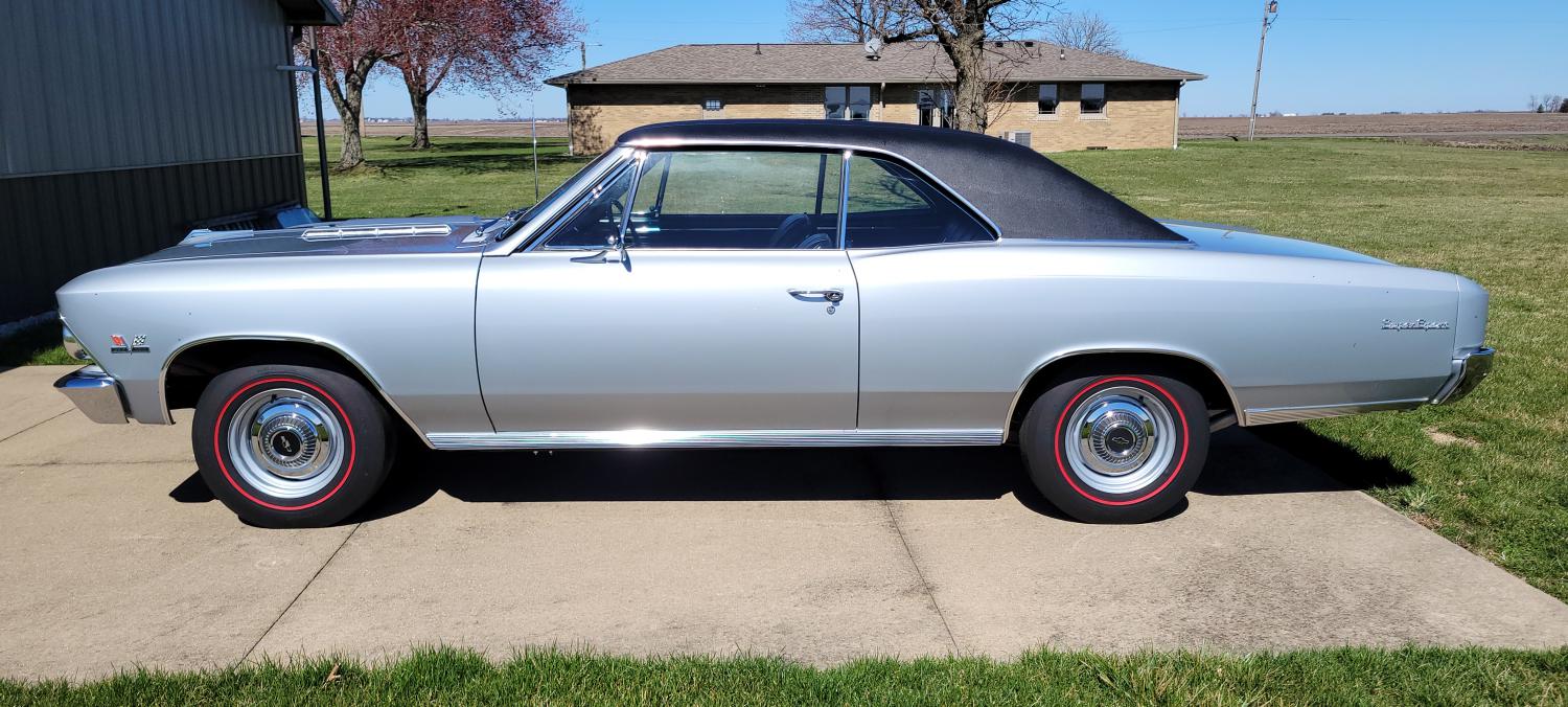

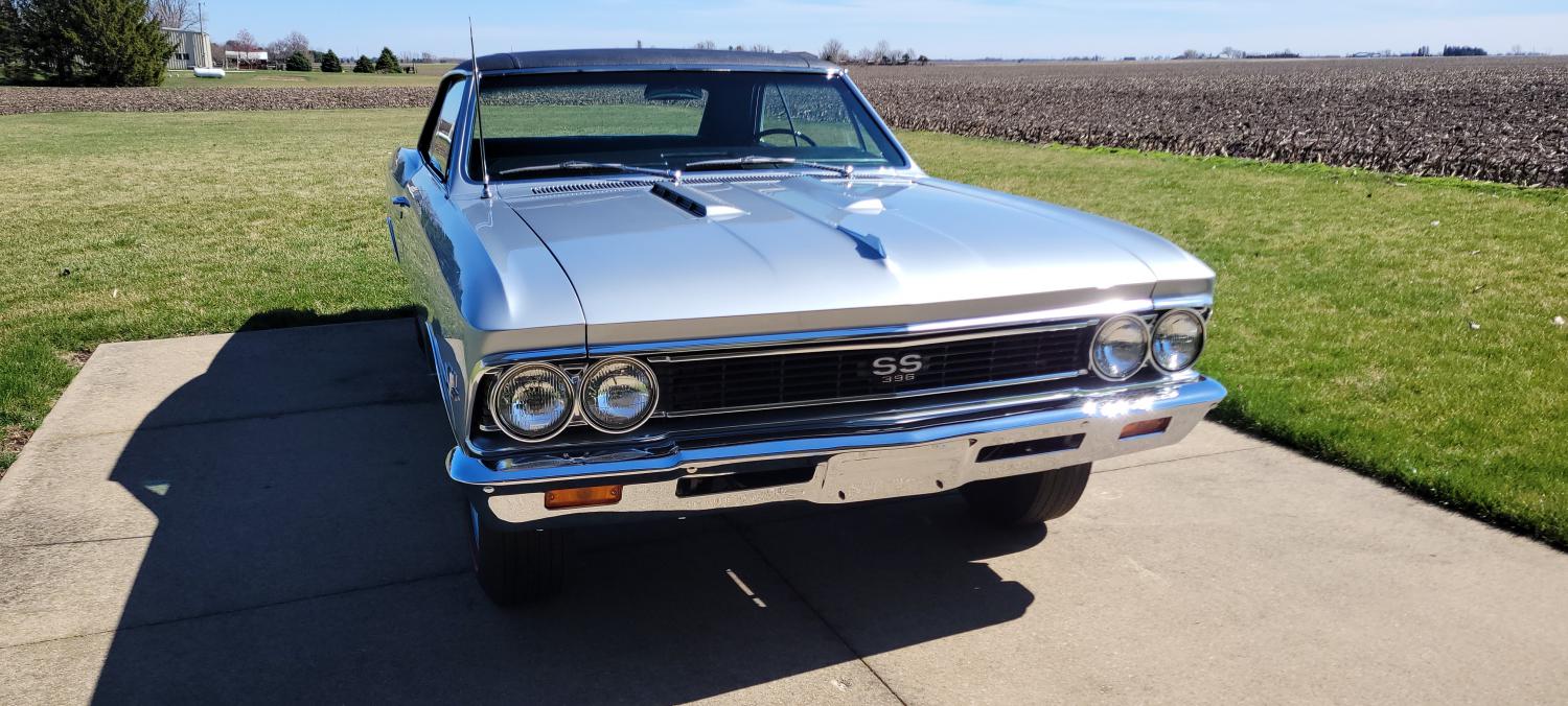

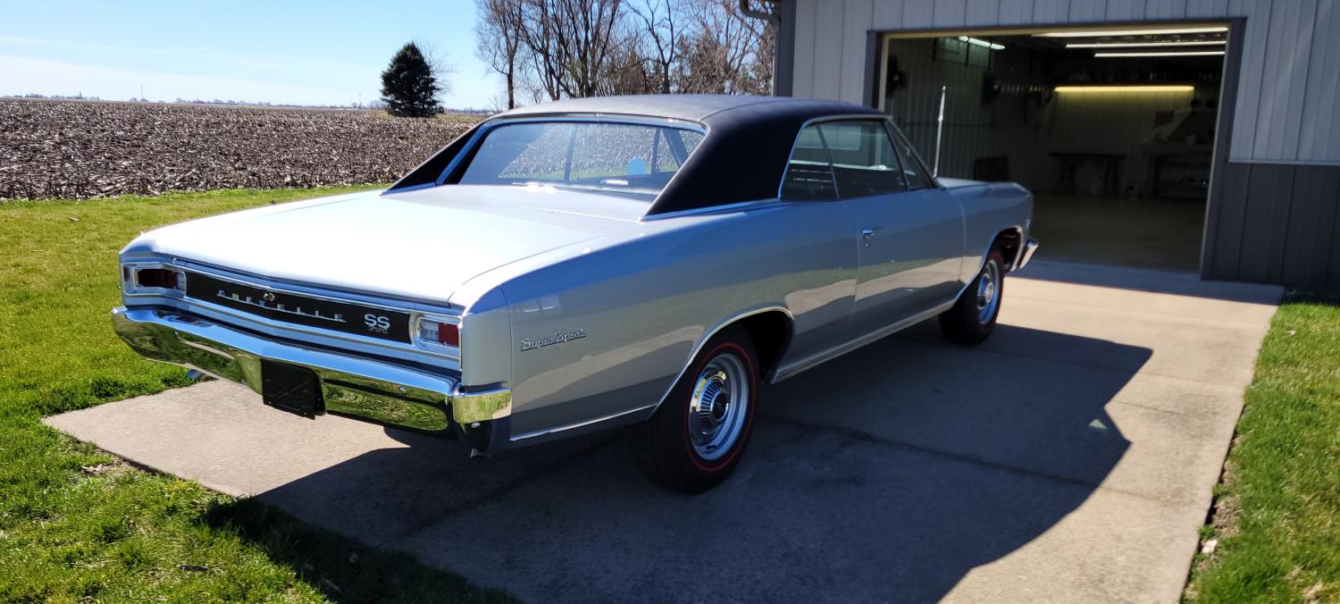

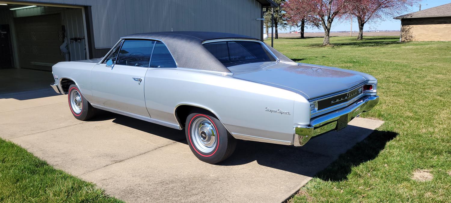

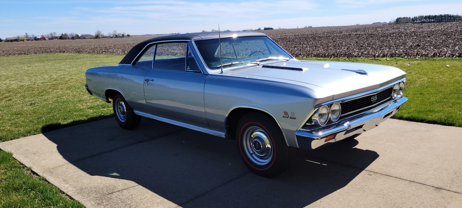

Default Restoration Complete
I think it came out ok.

  #215
Old 03-16-2024, 03:08 AM
mockingbird812's Avatar
Location: Dayton
Posts: 14,403
Thanks: 908
Well that is an understatement! Looks GREAT! Some under hood and interior shots pleez!
Sam...
  #216
Old 03-16-2024, 11:26 PM
OneStopRestoration OneStopRestoration is offline
Location: Washington, Illinois
Posts: 283
Thanks: 84
Thanked 1,411 Times in 212 Posts
Im a pretty hard critic of my own work, but thankyou.

scuncio scuncio is offline
Posts: 14,049
Thanks: 2,850
Thanked 7,136 Times in 3,270 Posts
Gorgeous! Best color for ‘66.

Old 03-17-2024, 12:22 AM
tunes's Avatar
tunes tunes is offline
Join Date: Jun 2014
Location: SW Missouri
Posts: 206
Thanks: 95
Thanked 97 Times in 44 Posts
Beautiful Chevelle! You do great work.

  #219
Old 03-17-2024, 04:22 AM
Tuna Joe Tuna Joe is offline
Join Date: Feb 2023
Location: Ojai
Posts: 158
Thanks: 192
Thanked 364 Times in 79 Posts
Absolutely amazing job!

  #220
Old 03-17-2024, 06:24 AM
chevyman0429's Avatar
Join Date: Nov 2008
Location: Clarkston, Mi
Posts: 1,718
Thanks: 345
Thanked 523 Times in 229 Posts
Not typically a fan of the vinyl tops but your car just flat nailed it. Always impressed when someone starts with a car in the condition most people wouldn’t touch and turns it into a masterpiece like you did Sir. Great job and Thanks for saving it!
