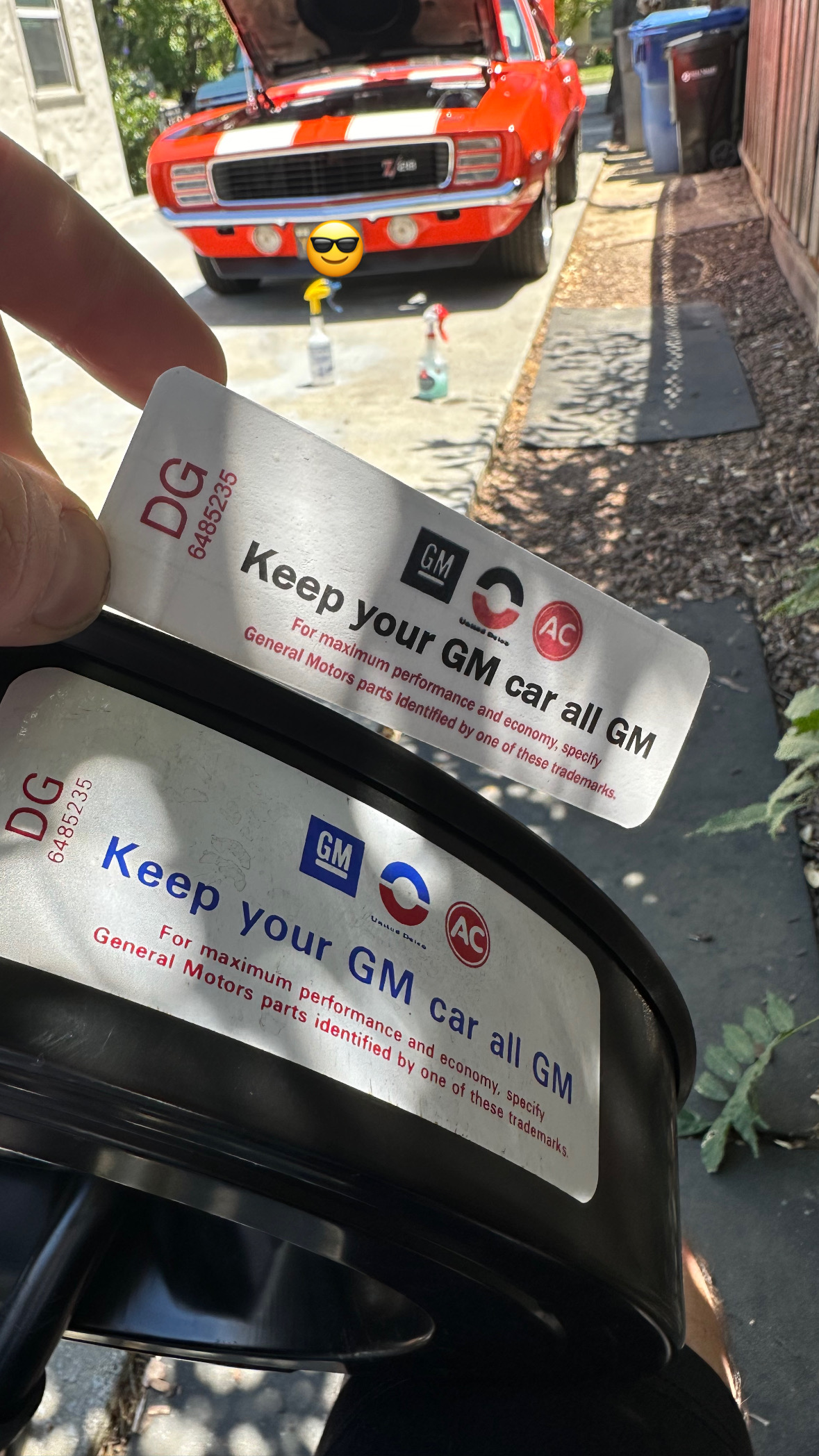

I got a set of beautiful decals from Don Lightfoot, so I went through and replaced all the decals from the original restoration from 2000-2010. I am guessing some of these were what you could still get over the counter at a dealer 20 years ago, but I’m grateful for Don’s work on all of these details!
For the posi decal, I used some Nitto tape and cut it into a rough “x” to approximate the way the decal would have been glued at the factory. That allows the edges to be a bit off of the paint which is a fun detail.

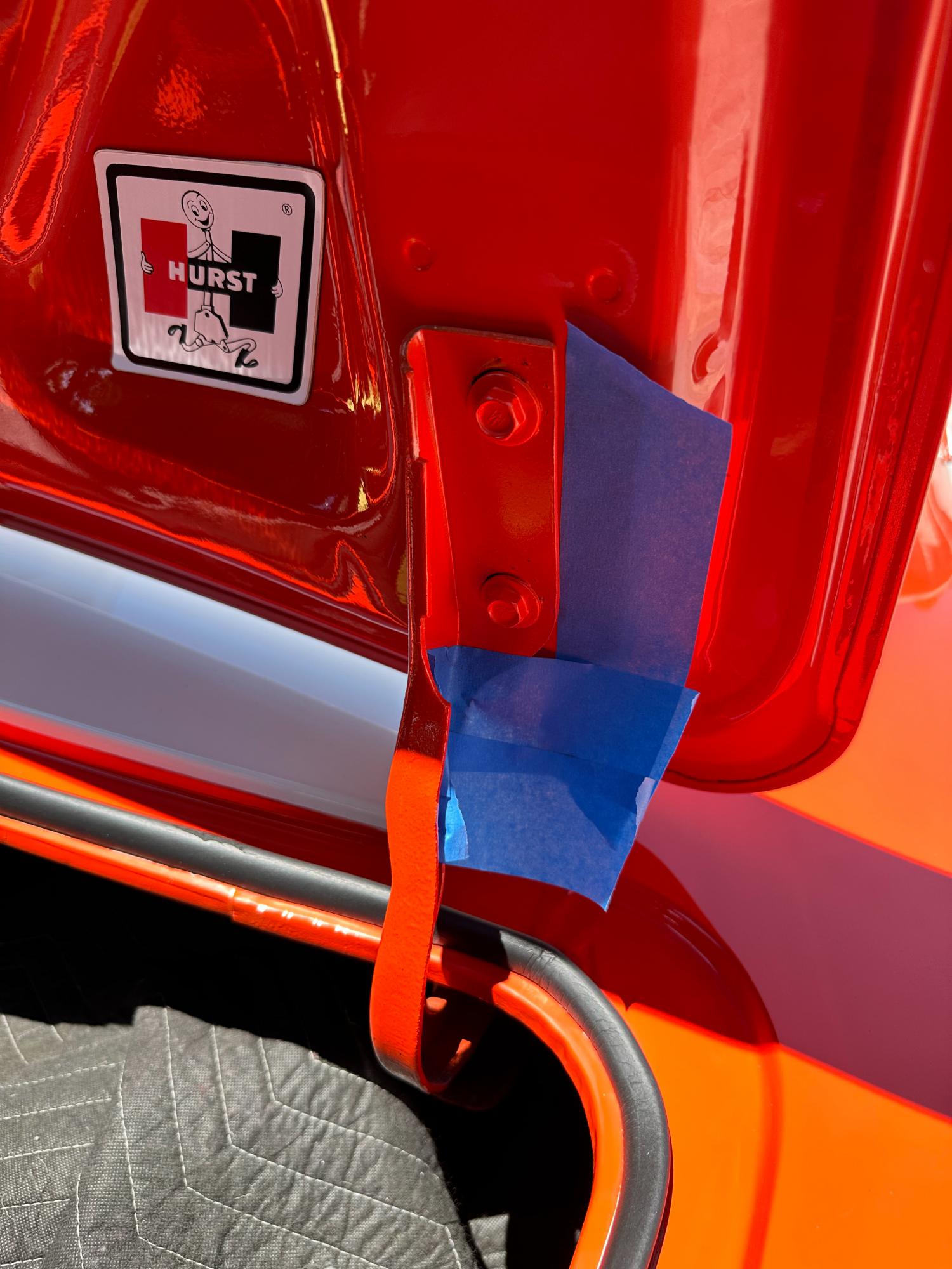

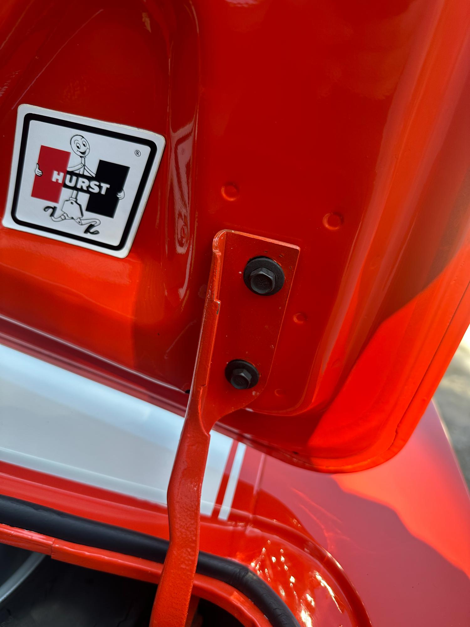

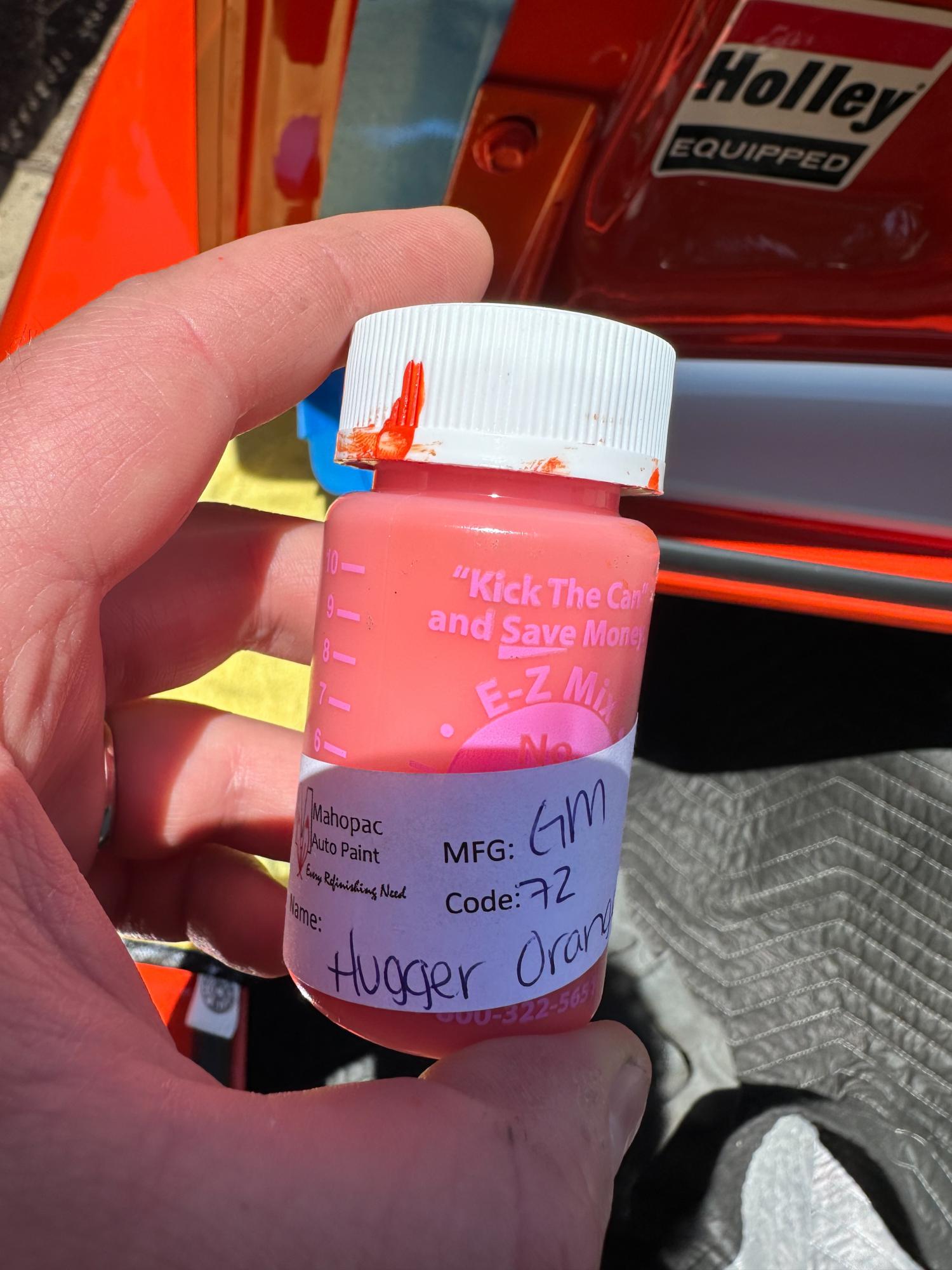

A few more details… I brush-painted the trunk bolts with hugger orange touch-up paint from Mahopac, after a layer of black primer, done two at a time off the car so as to not realign the trunk, then final touch-up on the car after wrenched down.

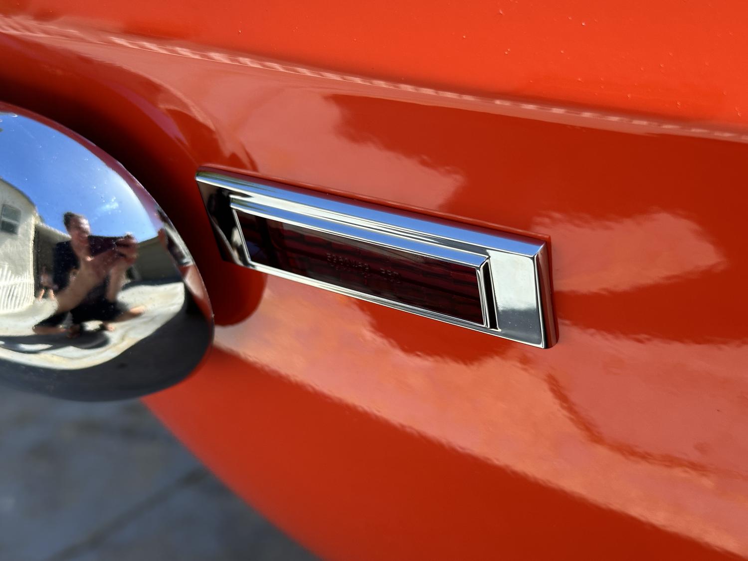

Restored air cleaner wingnut with repro stud - correct black nut for cowl hood instead of the chrome finish nut that would match a chrome air cleaner. I also removed the rear side marker exterior gaskets - looks a lot sharper with that polished bezel directly against the hugger orange. I guess those GM designers knew what they were doing…
