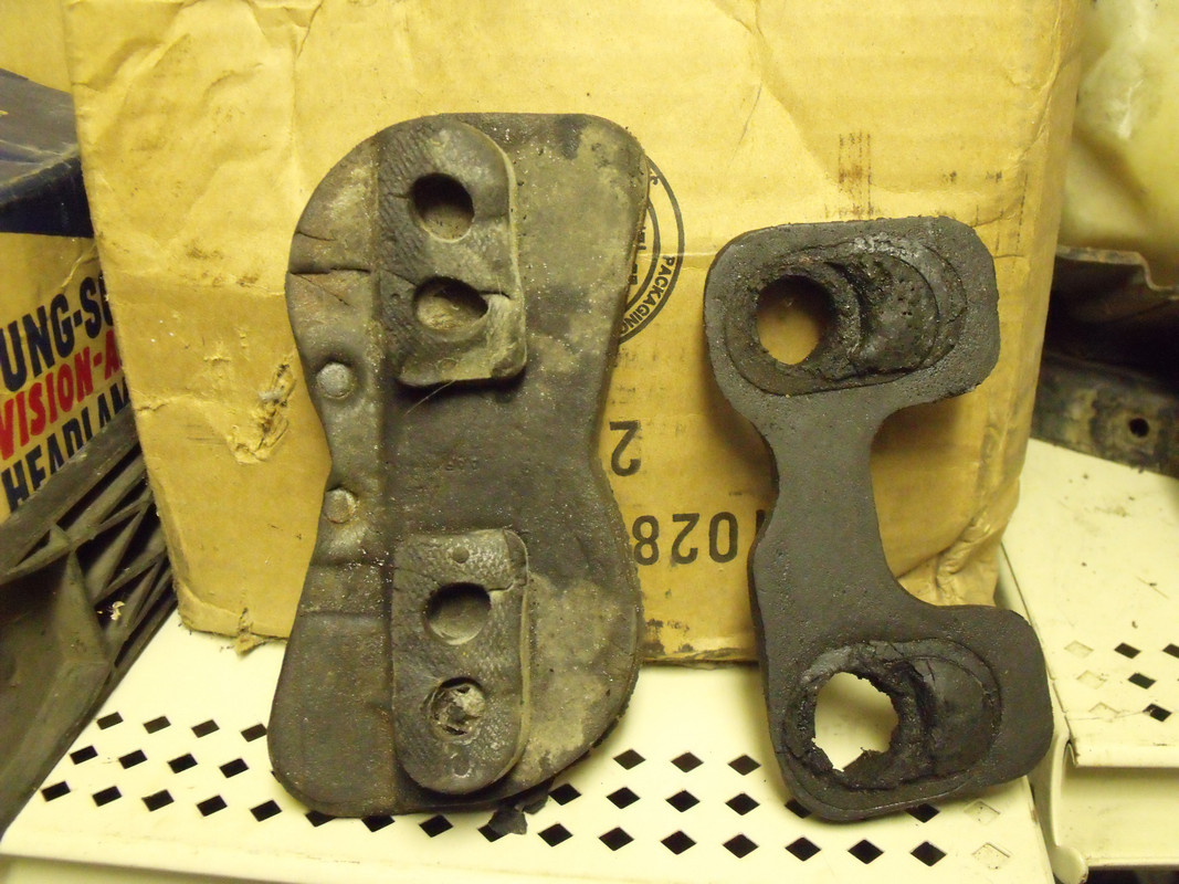

  #20
Old 10-26-2024, 11:15 PM
L78_Nova's Avatar
L78_Nova L78_Nova is offline
Join Date: Apr 2016
Location: Winnipeg
Posts: 597
Thanks: 10,230
Thanked 851 Times in 259 Posts
Default BB Camaro firewall AC suitcase inner
BB Camaro AC box inner half.
I'm told same as V8 Firebird.
Very pronounced dimple vs small block.

small block 68 Nova
