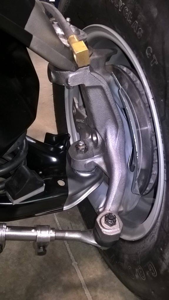

Anyone have specific knowledge of how the "Big Name" Restoration shops paint/coat the ball joint
end of Control Arms to make them look like the bare steel some of them were on early 70's GM F Body Cars........
PPG in their VIBRANCE Line, has a LIQUID METAL Paint that sells for $600/pint.........which is not a choice Im opting for........
I do have a Aeresol "2K Aerospray Detail Gray" (Bare Steel Replication) from Eastwood.......
Anybody have experience with this product ???

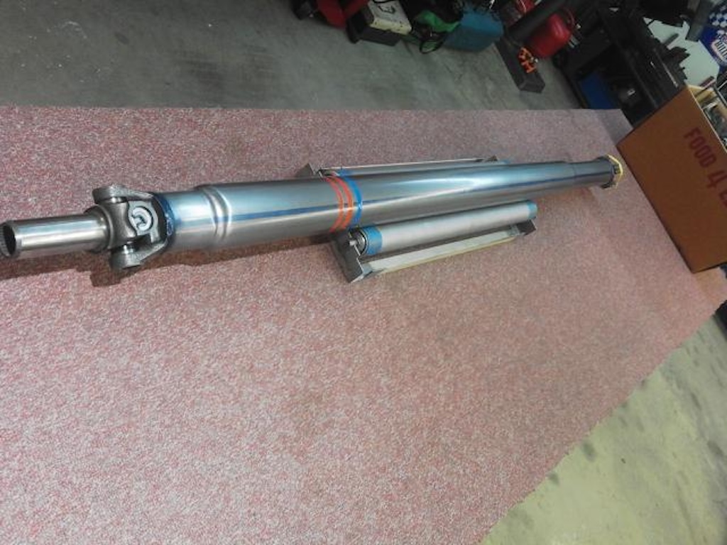

Any of the items I needed to look like raw steel, I used a satin clear on after I made the steel look correct. This is my drive shaft...Joe

It would depend on the part. That driveshaft was soaked in eveporust for 24 hours, rinsed, dried & then 0000 steel wool. Stripes painted & then clear coated everything. Some parts needed to go in the blast cabinet. I use black oxide & lower preasure so it doesn't scar the metal. Another thing is I live in southern Az so we don't have the rust problems other states may have. I can't afford what the pros may do so I have to experiment at home....Joe

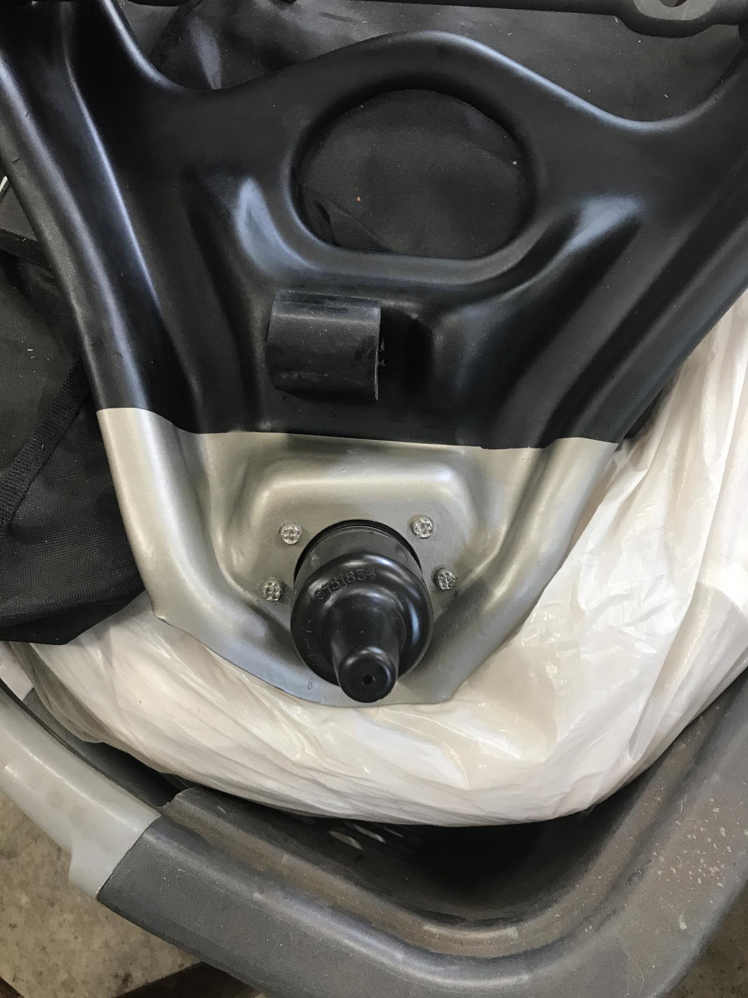

I used the Eastwood "Bare Metal" spray bomb paint. My guess is that is what you are looking at in your photos.

I have had good luck with Rustoleum Stainless Steel enamel spray paint. Works pretty good for the bare metal look...
