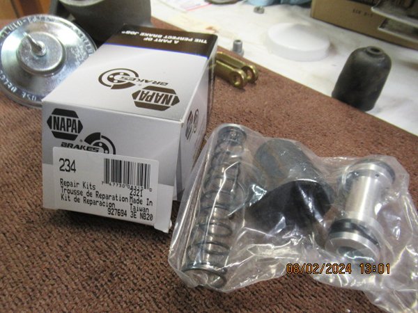

I had to get the guts of the rebuilt master cylinder installed so I dropped that off at my buddy's shop and he did that for me Monday. Picked it up yesterday and installed last night. He is also installing the new bearing races and bearings in the restored hubs. I got the proper front to rear brake line ordered and should have that in a few days.

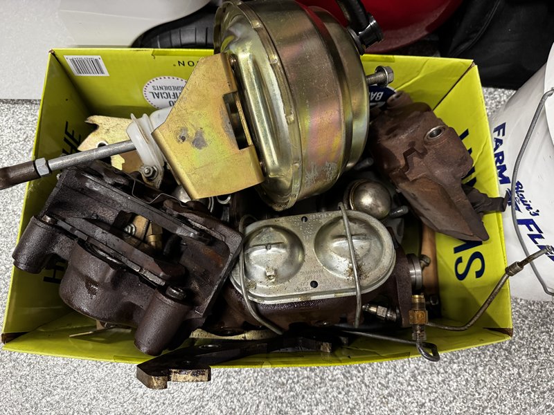

Made some more progress today......decided to dive in full bore on the drum brake conversion.
Jacob decided to come home for a visit and he didn't get any work assignments today so he was able to help a bunch. Dad would be over the moon ecstatic knowing his grandson was helping turn wrenches on this project.
We were able to get both disc assemblies off along with the requisite bracketry and related. Also took off most of the brake lines (I ordered all new stuff) with two exceptions. Didn't take the front crossmember line off as I need to spend some time strategizing how to do that with limited access to the fittings on the driver's side - and I still have some challenges with the front to rear line (a la the Chevelle project a few years back......). Whoever installed the disc conversion kit did some bubba engineering to the front to rear line. I have the new line here. I was able to get the front half (it was sectioned into 3 pieces vs. 1 and crossed over the transmission to go from the passenger side to the drivers side ) of the old line removed but need a fresh mind to figure out how to get the rest of the rear section out and install the new one piece line. I haven't had to cut anything yet and I think it can be done - just not today......
I will need to spend some time cleaning things up before any reassembly (30 year old restoration showing its age) but was able to mock up the driver's side backing plate assembly to make sure everything lines up - and it does. So once I figure out the brake line challenges it will hopefully come back together reasonably quickly.
If anyone needs a compete and good functioning front disc brake conversion kit I will be listing it for sale soon.

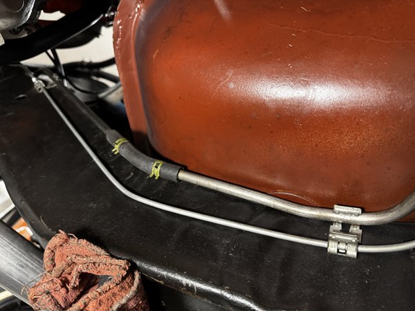

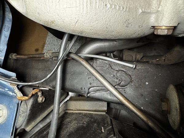

Spent some time last night in the garage and was able to get the old front to rear brake line out. Went to install the new line and saw the front end flare was boogered up pretty good so that ended that project for the night. Supplier sending a new one out today.

Got the new front to rear brake line installed, it intermingles with the fuel line and uses the same bracketry so it took some patience and creativity to make that all work without cutting anything, having the body on the frame, and doing this on my back with the car on jack stands.......but it's done and it fits. I also removed the front crossmember line and installed the master cylinder to frame line.

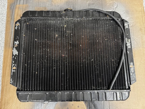

I dug a little deeper into the project and took the radiator shroud and radiator out. I will have the shroud re-painted and I think I'm going to have the radiator re-cored as it has several spots were the fins are bashed in pretty well over the years.

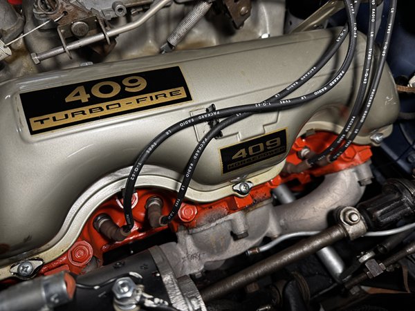

I ordered a few more small parts yesterday and also installed a new set of valve cover decals and re-installed the opti-kleen decal that had come off.
