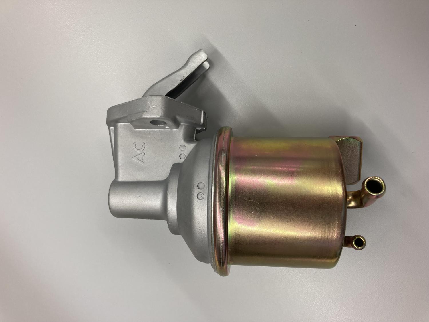

Originally Posted by CamarosRus View Post
I'm wanting to SEE pics of what show quality restored AC Fuel Pumps should LOOK Like
Here is mine as received back from Fred Ballard in 2021
Jake Dykstra
169INDY, The (upper) Cast Portion appears to be coated with Aluminum Paint ?????
I need to replicate Original as mfg finish ..................
There is no aluminum paint on the casting. The castings are cleaned with light media and I use a low gloss clear coat to keep dirty fingerprints off of the surface. I also have an utrasonic cleaner but it is no match for some of the original staining that a lot of the pumps come in with. That way any dirt or fingerprints can be wiped off with acetone and a rag. I also offer to not add the clear coat for people who have a lot of pitting and plan to repair that part on their own. I would be interested to see how those repairs come out. The fuel sections are cleaned and then tumbled before I take them to the plater. All of these processes have been improved by me incrementally over many years.
-Fred-
