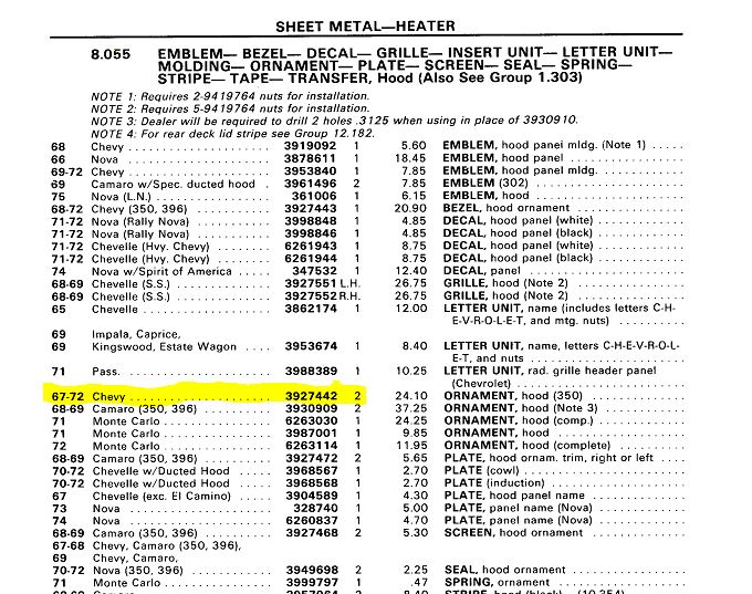

Originally Posted by 1967 4K View Post
You are aware that the Nova vs Camaro louvers are different.
gm part# 3927442 according to the GMparts manual are listed as same part number, can you show the part # you are referring to so we can compare.Thanks Marc.

Oct 1970 reads 3918784 for 1967 Camaro 350 396 & 1968 Camaro w/350....Joe

I just looked at my NOS louvers and they are both 3927442 and DO have the curvature. I have 2 Nova bezels that have a GM part # 3927443 and appear flat. Not positive if they are original or repro. My originals are on the hood and I didn't remove them to check.
