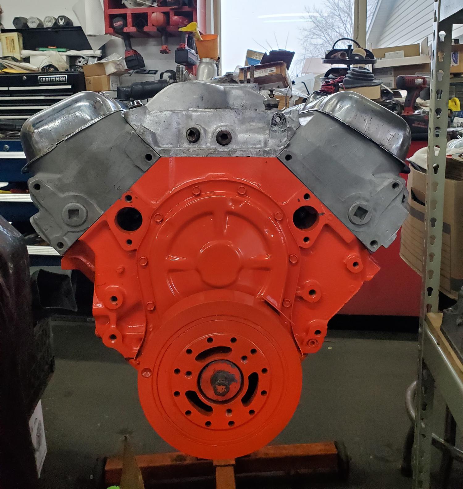

Mark good to know I'll stop looking for anything more I just figured there would be more of it
so these 842 heads are about done they were milled enough intake needed to be milled down .060" and .125" on the ends 3 trips to machine shop anyway its fitting much better, someone did me a favor and had welded up the crossover, glad it wasn't the date that should be on the car

well, I'm glad that's finally done! now to find a weekend to do the swap the nice thing about a beater is this will only see limited nighttime use its next caretaker can make it pretty.
the drivers head has a plug where temp sender should be and it looks like its been in there a long time and I don't want to break a tool off trying to remove it - any suggestions?

Originally Posted by big gear head View Post
That's the same 90005 FelPro gaskets that I always use. I love those gaskets. Be careful with those valve springs. Rust on a spring can cause it to fail.
those were on heads when bought and I trashed them, just best pic showing the plug I want out headshop installed outers of comp duals for break in
