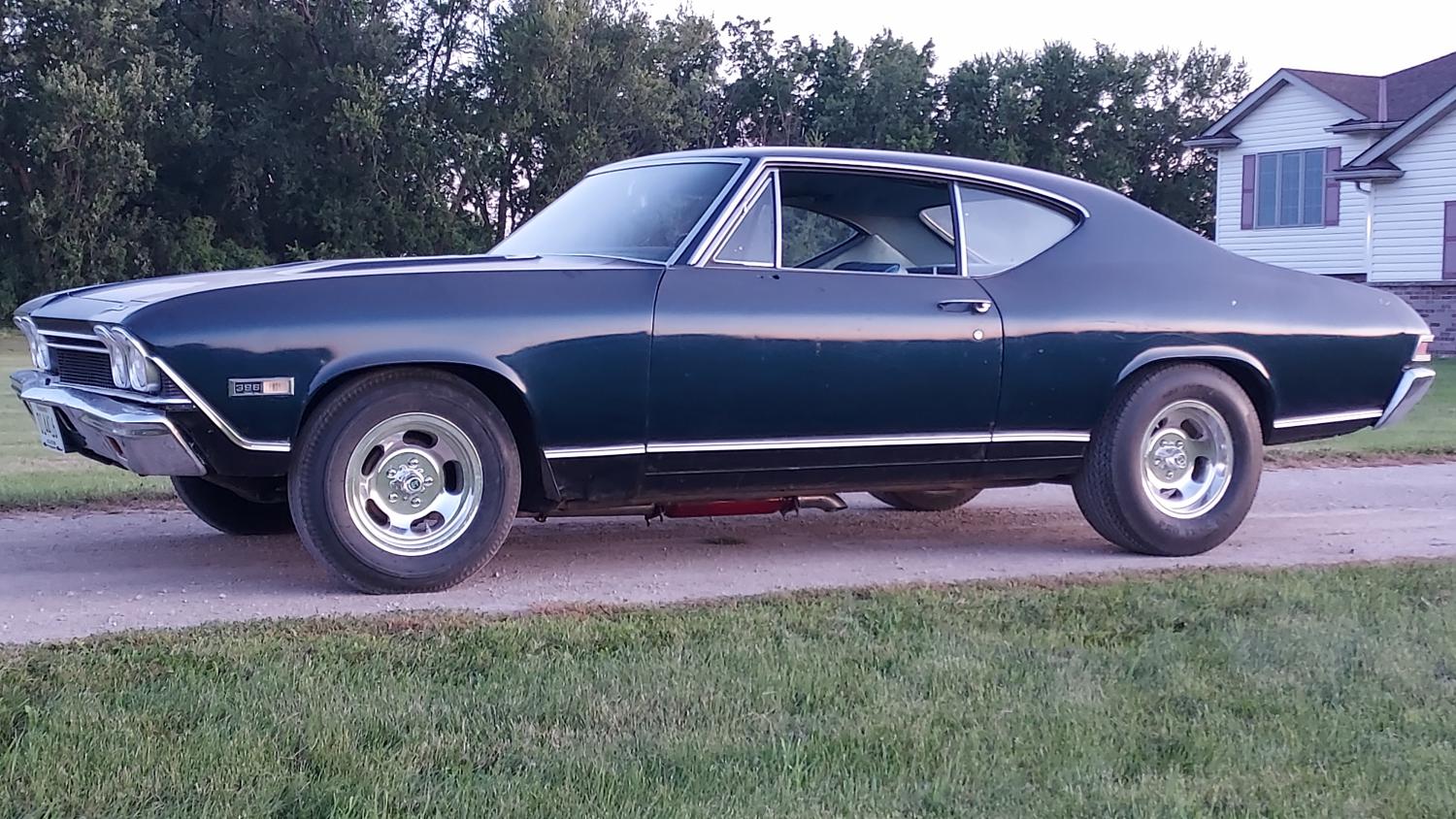

Radials look awful on 4 inch wheels. I've got Firestone 6.40 15 on my Camaro. They are about 27 inches tall.
Freddie

I love the 6.40-15 Firestones. They look great with an L60 rear.
