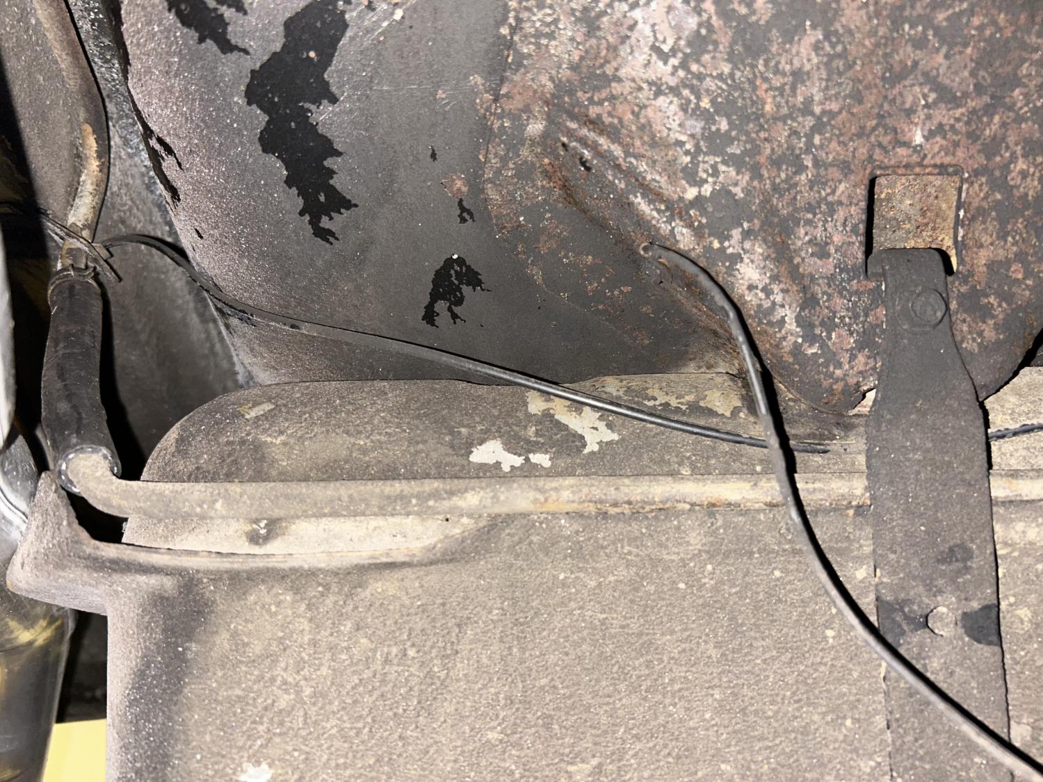

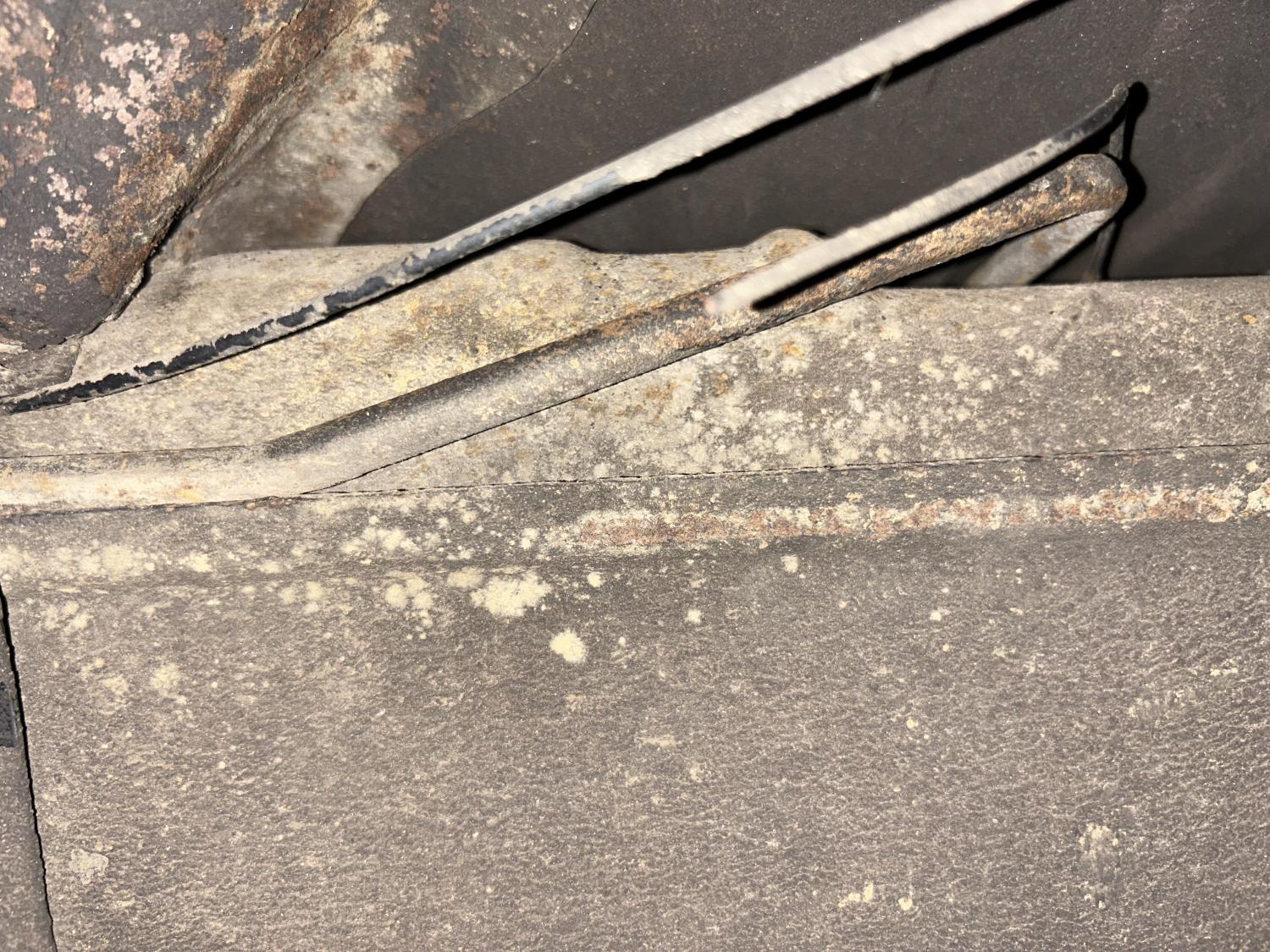

Hoping someone here may have some info on the differences between L34 and L78 sending units. I’ve got a 69 Nova that I believe was an L78 and was under it yesterday getting pictures of the single fuel line and noticed the sending unit only has one single 3/8ths line coming out. I’ve done some research but no one’s ever given a set answer. I would assume the L34 would return to the tank through the sending unit?

A L34 would have had a return line. I looked in a 69 Assembly Manual to make sure and it does show a return back to the tank. So, it looks like you have a L78 setup. Post some more pics of the car you have. Guys here love the pics...

Ive looked for good info on dshaft stripes and havent found a solid answer, im sure there were assembly line anomalies but to have a single fuel line and correct alt with pulleys as well as the clips being different for the l34 fuel lines etc im still leaning towards l78, this sending unit has never been out nor has the fuel lines.....but without a block or paperwork who knows. the fuel pumps were different between l34 and l78 so if it was an l34 and it got a single fuel line then it would've had to use the l78 pump...i doubt it
