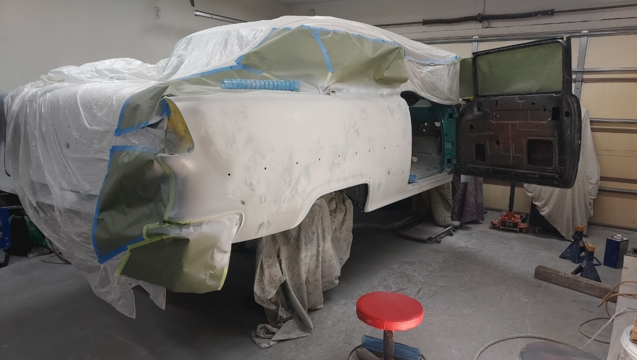

Cale filled and blocked the driver's side door and quarter panel, taking them as far as his skill level could get it, while I've been working on the passenger side.
Passenger side is about ready for its 2nd round of fill primer and blocking. Not sure yet if it will be good enough after 2, or will need a 3rd... Cale is moving on to trying to get his 406 fired up on the run-stand while I continue to block sand.

Passenger side is as straight as it's going to get... it needs one more 180 blocking to get the last of the little imperfections out before its final prime, but we are moving on to the driver's side for now, while this side sits for a while to allow of any shrinking in the primer before we sand.

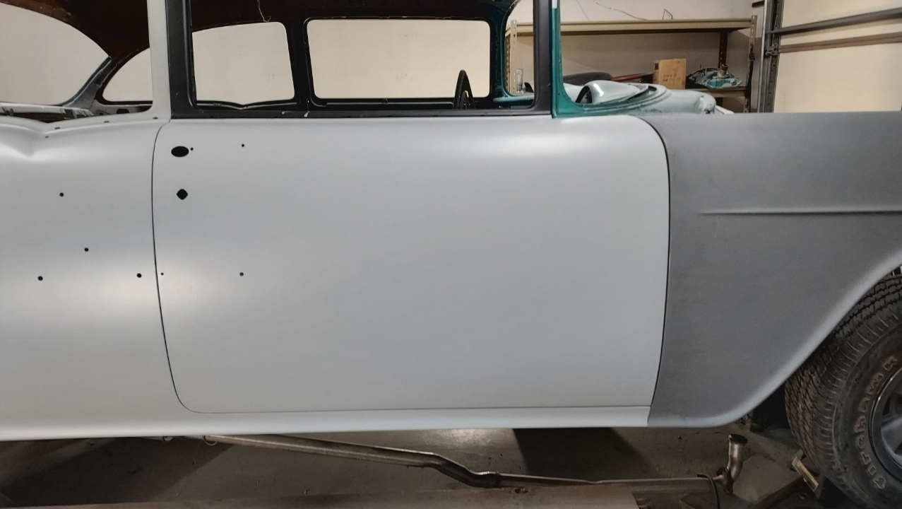

Also, we did a quick check of the door/fender gaps to make sure there's nothing needing any rework. They looked better than expected for parts that were finished separately from each other. Very acceptable gaps and panel curves matched up nicely.
