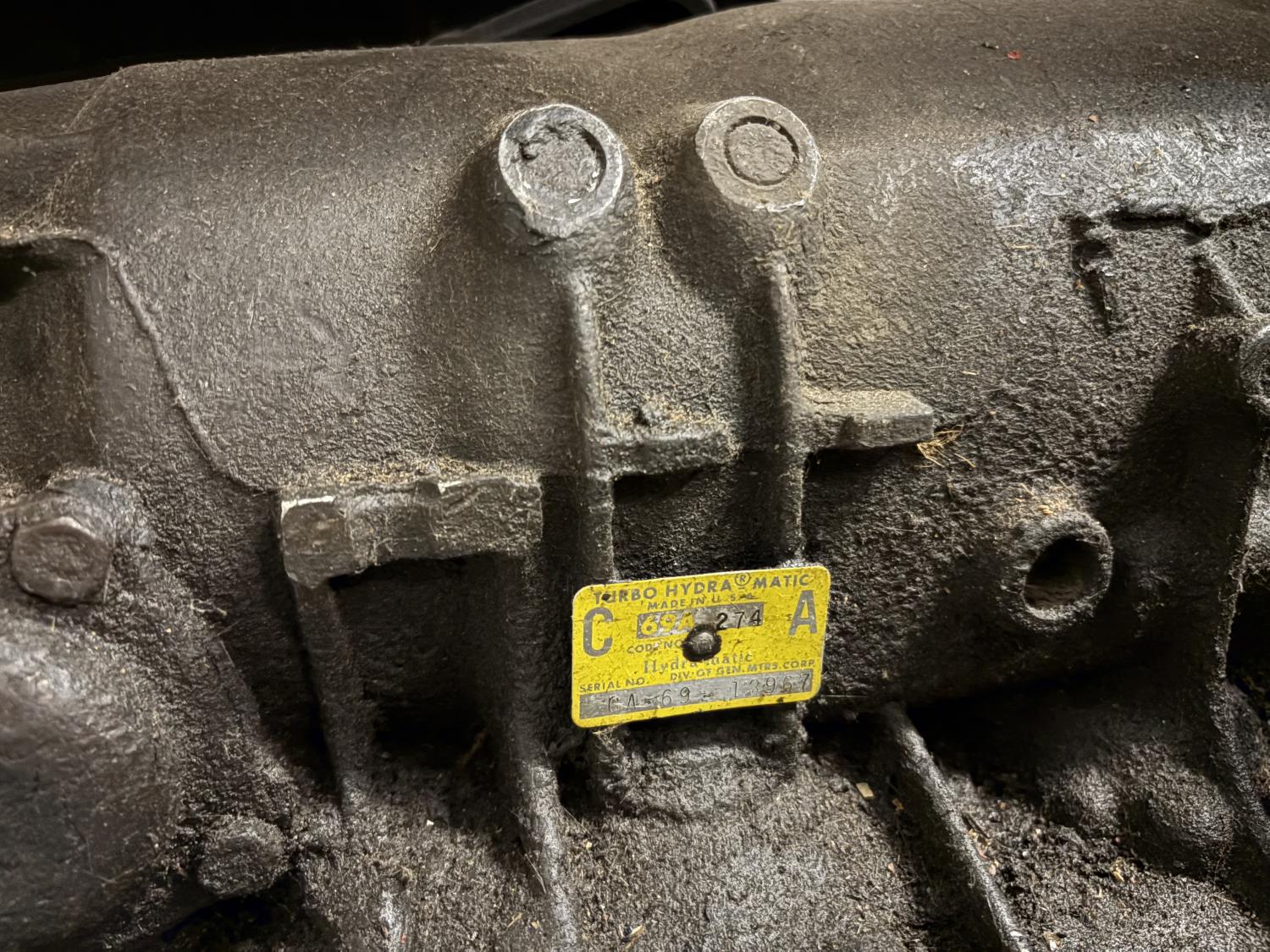

Also, Grady's 69 Camaro has the VIN stamped on the CX trans at the top of the bell housing. I don't have a picture of it, but the screw driver in these photos shows where I found the VIN on this TH400 Coded CA. FWIW.
Phil Woj

Here's a picture of the alternative VIN location, top of bell housing, driver's side 69 TH 400. Phil Woj.
