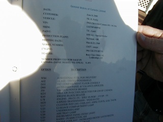

I was told that there was a air pump delete for some copo camaros Is this bull

Here is the GM of Canada paperwork for the low mile 68 L78 Camaro that was in Scottsdale 2001. KD1..Less air injection reactor for GM of Canada.

While I agree that the COPO Camaro's and Chevelles in 69 had air pumps, and I know the automatic vs 4 speed Camaros is always a discussion point. But, with some owners of the Chevelles, why is it that on the build sheet the air pump boxes are always left blank? Should there not be a code in this box if the car came with one. I have been asked this question many times and I really dont have the answer, except cars that are known to have air pumps since new, that there build sheets are blank as well. Any answers????

Very interesting photo!!!!

Yup, but the smog delete for Canada was only in 68. The question was about 69's. [img]/ubbthreads/images/icons/wink.gif[/img]
I'm not sure how that KD1 option was handled in 68 in Canada. I see L78's and Z's documented with and without it.
Unfortunately, KD1 is one of the few options that we don't have the production totals.
