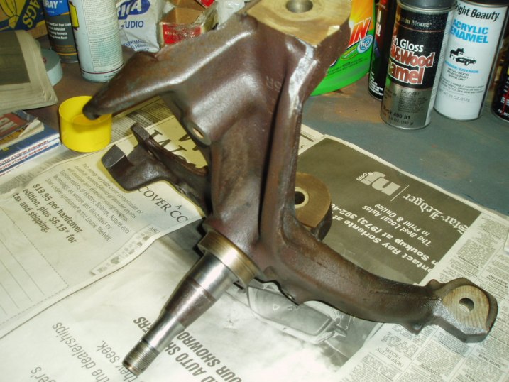

Default Re: Spray Day
The other side of the driver's spindle has some green drips here and there and a black paint daub by the dustshield mounting boss.

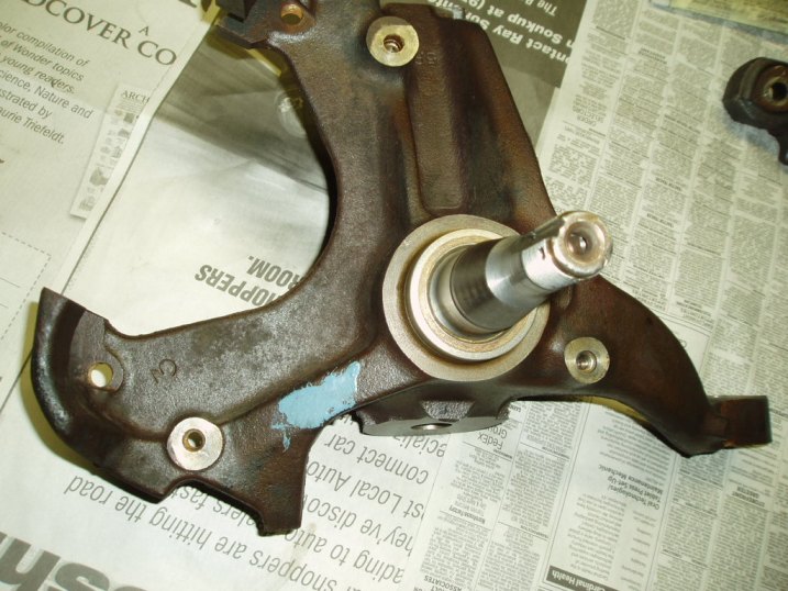

The passenger side spindle has a "Petty Blue" paint mark on it.
  #83
Old 07-18-2005, 03:42 AM
njsteve's Avatar
njsteve njsteve is offline
Join Date: Nov 2003
Location: NJUSA
Posts: 8,325
Thanks: 8
Thanked 2,642 Times in 819 Posts
On the other side of the passenger spindle is a yellow 1/4" by 1-1/" line near the caliper mounting hole. After cleaning the spindles I sprayed them with a wax based metal preservative called Nylac. I am going to reinstall them as is and not remove or alter their orginal condition.
There is also a white paint mark on the top of the pass spindle running down the side.
