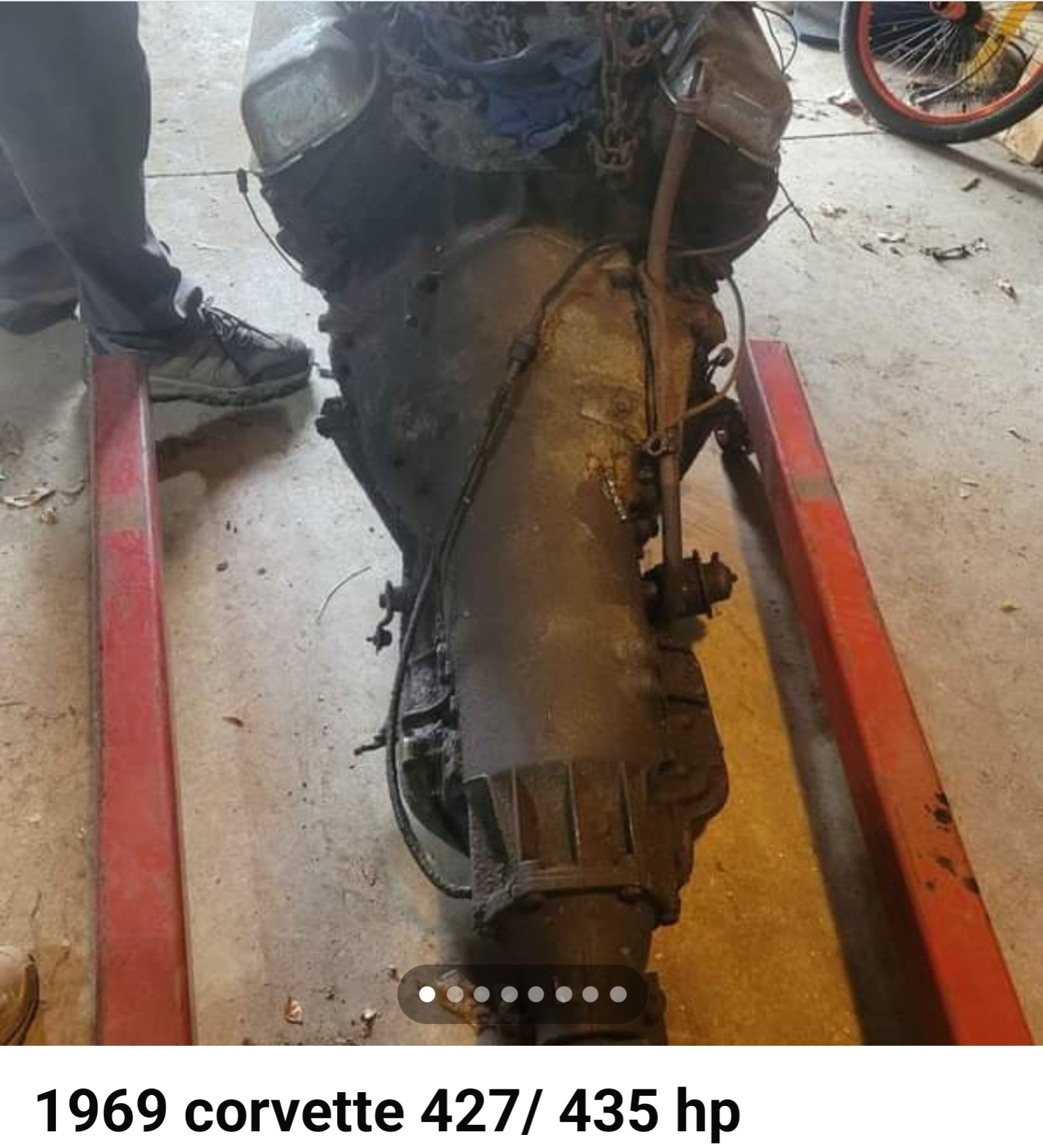

Attachments - The Supercar Registry th400_partial_vin.jpg TH400 Date.JPG Screenshot_20240626_105100_Gallery.jpg IMG_0379.JPG

Default 1968 CY Trans details
Here are some detailed pictures from a 1968 CY THM400 trans, courtesy of Tommy K and the Super Car Workshop...
