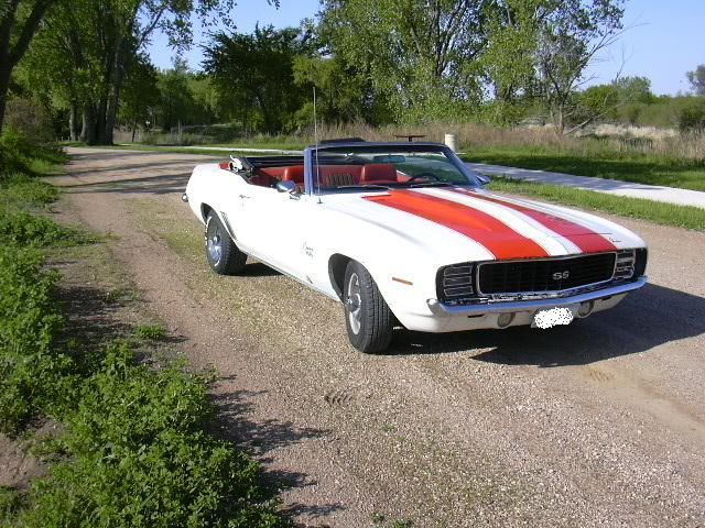

First one I know about is 02D VIN N607547, which is prior to the two real pacecars. This is what it looked like about a year ago.
Mark C.
