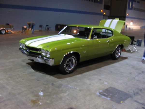

Dave G's old LS-6 Chevelle @ Chicago VetteFest 11/04.

It says on the paint sheet that citrus green (43) is not available on LS-6 cars???? Wonder why that was. what difference did it make?
