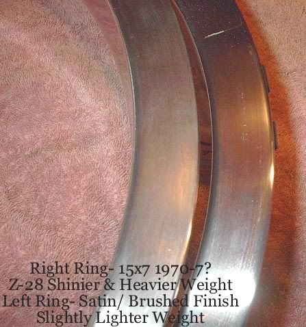

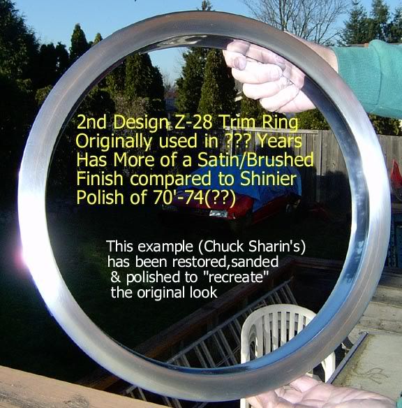

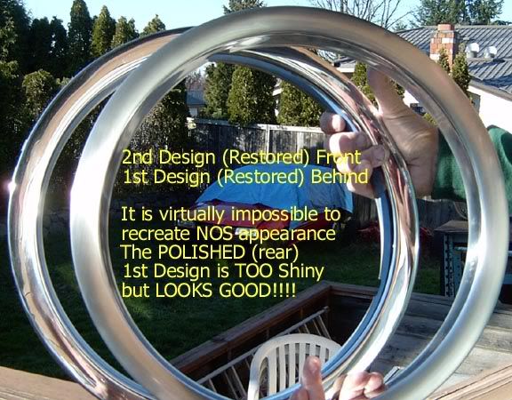

Below I will show misc pics of CORRECT 1st (70-74) Trim Rings and the later 2nd design (77-81) Trim Rings which many people use (incorrectly) on 70-74 Z-28's. There are also different designs of lug nuts and BowTie Center caps.
Chuck Sharin
