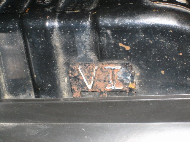

The radiator tag is VI, see pic.
PaulD

Good Rag Tag picture! Paul has the exhaust been replaced? I am curious if it has the LONG style or more common Short style exiting behind wheels? and what the Gas tank looks like.. signs of black out vs. bare steel? I would not have thought your car would have SMOG, no surprise there, it also has the appropriate SHROUD for the radiator and not a FINGER GUARD ( as most 66 and 67 SS's should have finger Guard ) Yours having the heavy duty radiator option, got the Shroud
