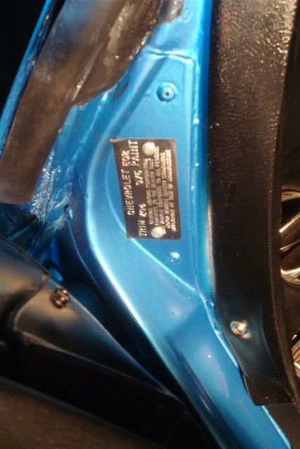

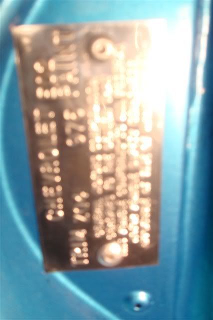

looks about right to me
![]() I'm not a corvette expert, but owned a 69 427 vert too. the trim tag on the vettes IS shiney, not painted or black like the trim tags on passenger cars. The block stamping looks to be the right size(s) to me too. I'm sure if I'm wrong someone will let us know ![]()

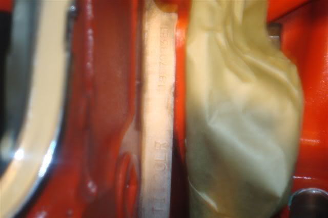

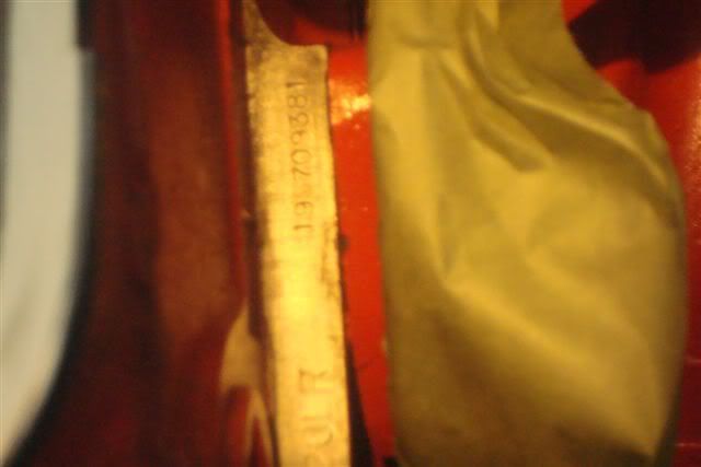

#17
There is no doubt in my mind that the motor is a restamp. The picture of the trim tag is too blurry for me to make a call on that. Sorry to be the bearer of bad news.
#18
what really concerns me is the shiny trim tag that looks brand new,and theres no tape marks from being coverd up before painting,
