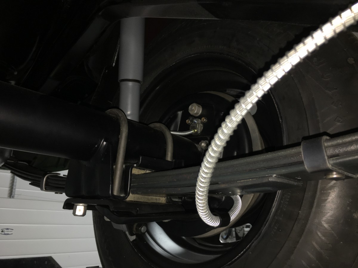

The mounting plate appears to be the LH one installed on the RH side? The notch for the parking brake cable hanger should face the front.

Good eye Rob. I didn't notice they were backwards until I did the brakes earlier tonight and went to go put the brackets on. Guess what I'm doing tomorrow.

Couldn't leave those plates until tomorrow as I already have a full plan for the day, so I went back out to the shop and reversed them tonight. Also need to order some new drums which will finish off the brakes before I start plumbing hard lines through the front. Getting there (even with the odd two step)

On the axle I used t-bolts on the inner and u-bolts on the outer, without washers. My 69 is an 02D build. Do you know which is correct?

I've seen them staggered the way you mentioned, and I've seen them using both u-bolts on the inner and outer. I'm sure there is a factory correct method and would think it is as you mentioned, but I am OK with using 2 sets of full u-bolts. My thinking is perhaps it's stronger?

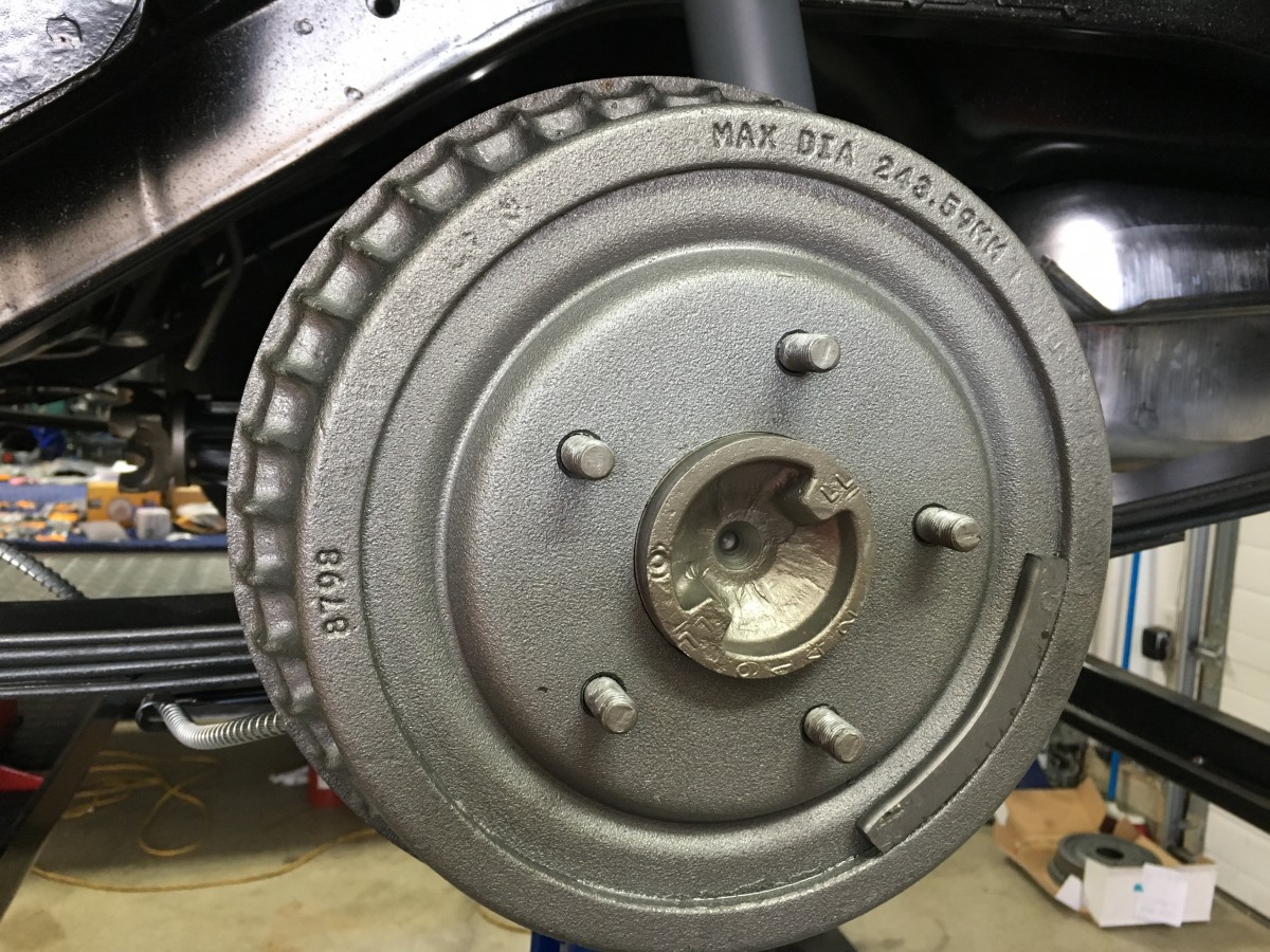

Finished the brakes today and installed some new drums to help it stop.

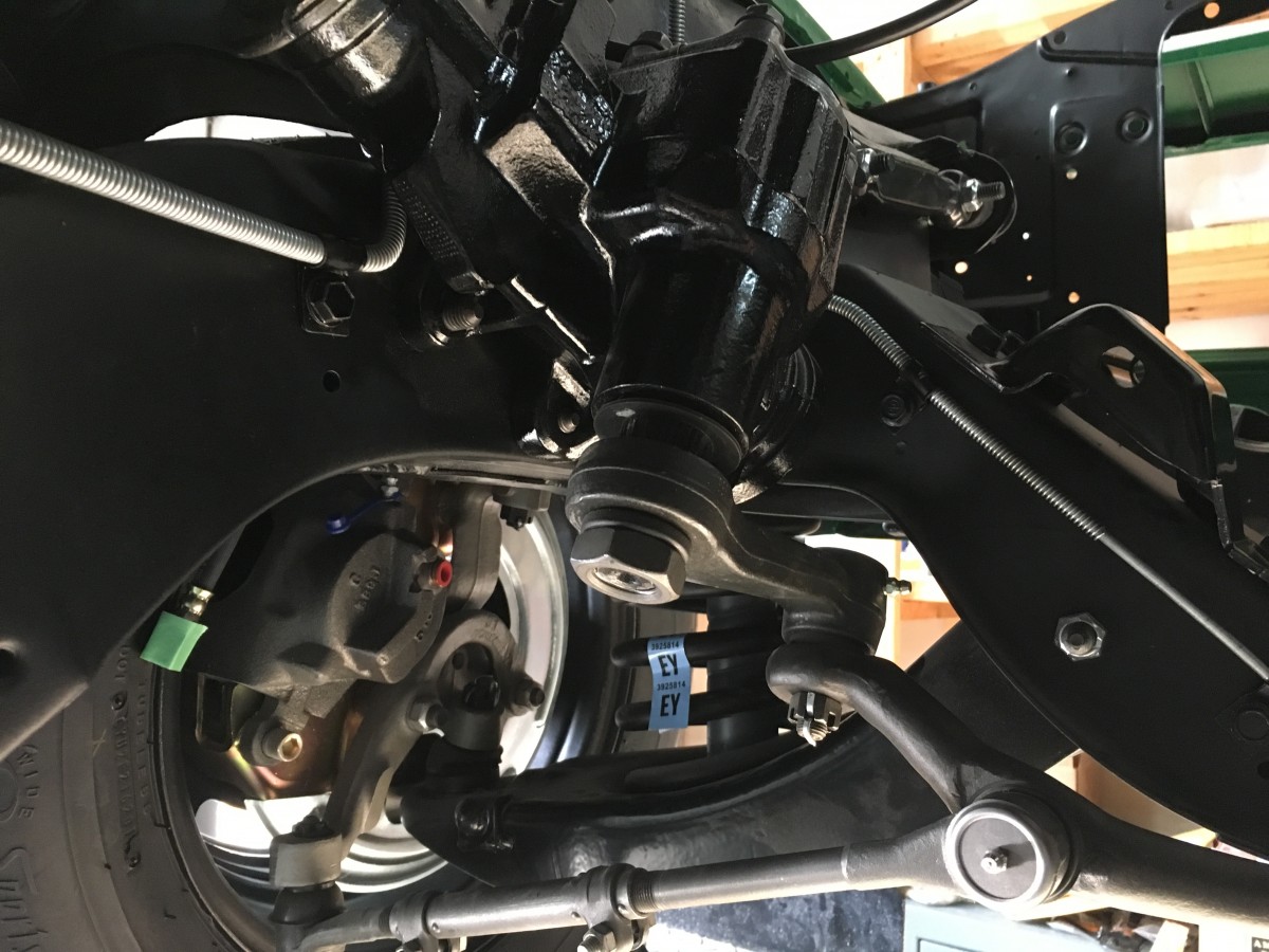

Ran the remaining brake lines today and almost ready for the master.
Added a couple decals to the front shocks and springs. (not going to go too crazy with all the markings)

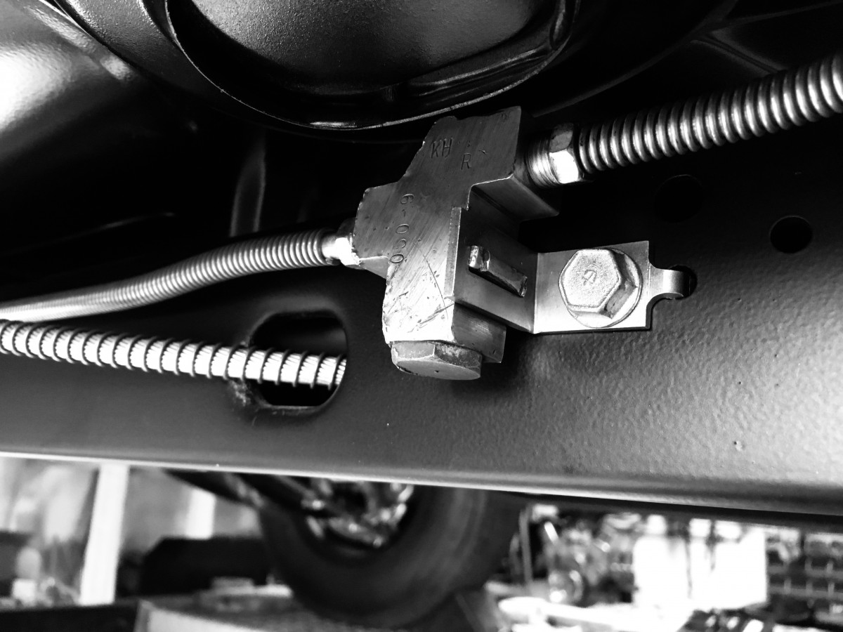

Added new e-brake cables throughout the car today.
A pair of T-bolts (inboard) and one U-bolt (outboard) per side is how the factory did it on a multi-leaf rear, but it's common to see the T-bolts swapped for a second U-bolt to reduce the tendency for spring perch welds to crack.
