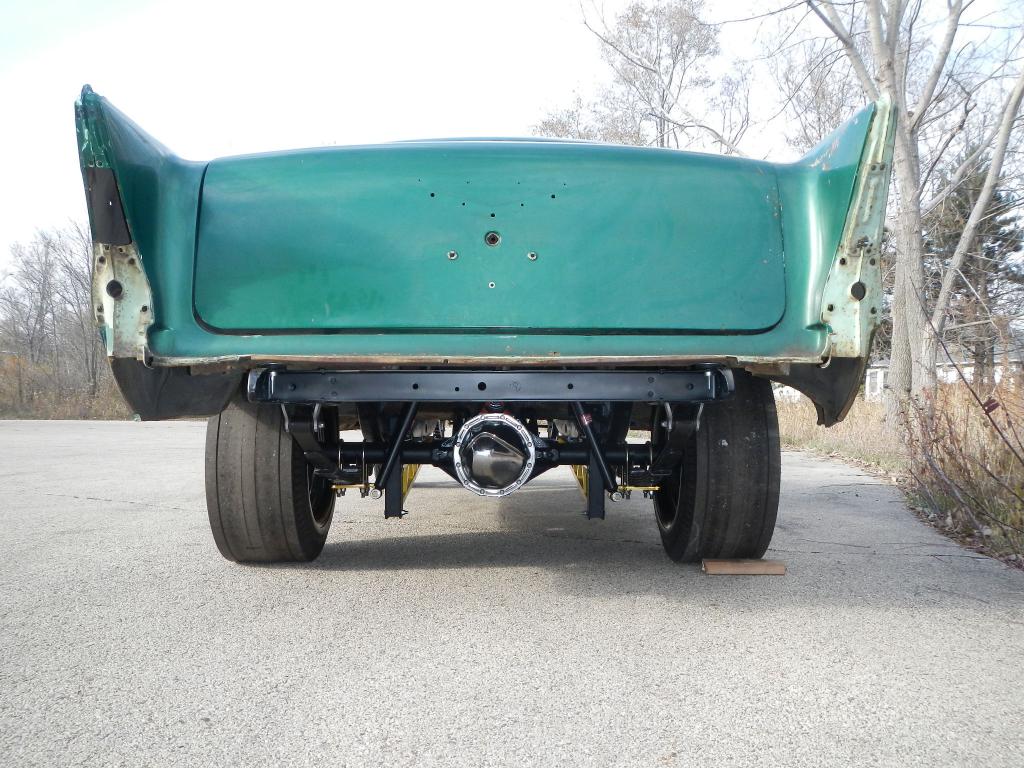

Originally Posted by big gear head View Post
This is what Im going to do as then I dont have to move the gas tank.

We move the rear springs to under the frame rail with the pockets. It leaves more room for other things and works just fine.

Yep, I did that on another car, but no ladder bars on that one. This one will get ladder bars under the frame rails with the springs inside. We bought a stock sedan gas tank and not having bars inside the frame rails will help with that fitting without modification....I hope...

What do you use on the front of the ladder bars to allow them to move rearward when the springs compress ?? I've read a fair amount about very harsh ride and brackets cracking if the bar can't move with the axle.
