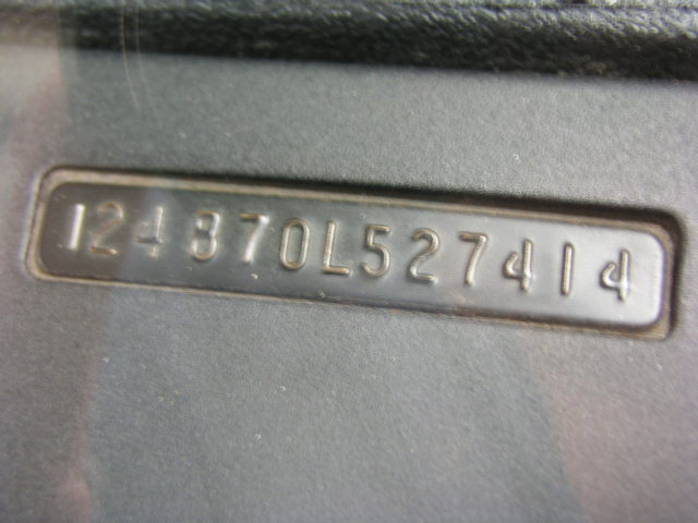

I can't imagine any reason for an assembly plant to date-stamp any component; my Production Engineering Group supplied the G.T. Schmidt VIN derivative-stamping tooling (for the body and for the block pad and the transmission) to all Chevrolet assembly plants, but we never supplied any tooling for date-stamping. I'd guess those date stamps were applied at the subframe manufacturing source for traceability. I don't recall who made the "F"-body subframes, but most Chevrolet frames were made by Dana, A.O. Smith, Parish, and Chevrolet-Bristol Road Stamping in Flint.

Default Re: 1970 Camaro hidden partial VINs
70 LA car with N on the Subframe
Well, Checked my Z frame today....sure enough...the numbers on the frame are...20370N1....I did not have my camera with me or I would have taken a pic... it seems to make sense with an 03A car...right??? thanks for the info guys....
